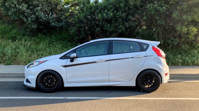

@FiestaSexyTime wrote here:
and finally, what you've all been waiting for:
D-D-D-D-D-D-DROP THE FIST *DUBSTEBNOISES*

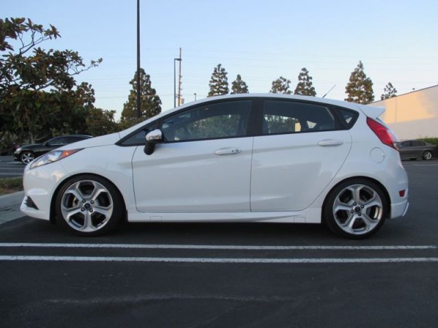

@koozy wrote here:
ST Springs w/Bilstein B8's
@bustervic wrote here:
Ron set me up with some ST springs. I'm very happy. Not harsh or bouncy and feels very planted.
Don't overlook these.
@koozy wrote here:
From here : Drop is 1.2" Front, .6" Rear. There's a slight rake. Here's a photo taken a few minutes ago.

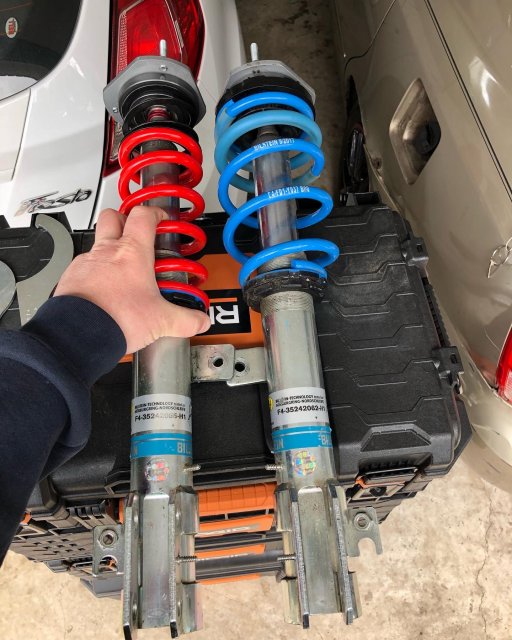

Some pictures of my completed b-spec setup....
Left b-spec / right B14 kit
I also have a shot of the front dampers from 3 different kits:
Left is HSD Monopro w/ 6k(7" length) springs, Middle is the b-spec and right is the B14 kit. None of the B14 kits are adjusted for height. Just put together.
I had totally misunderstood what you were trying to do, until this post.
I had thought that you were going to use re-valved B6es/B8s, and that Chris Taylor (or whomever) was going to fabricate some threaded sleeves, collars, top mount/camber plates, and rear weight jackers, to go over them, a la Ground Control, in order to turn them into a coil over setup, not use the dampers from the B14 kits.
kevinatfms
897
949
Germantown
Nope, i am going to run the exact setup that is legal in b-spec racing not using the Eibach based coilovers. B14 front dampers are a monotube 46mm bore Bilstein inverted damper. Divorced rear setup though as Eibach is the only company that made a coilover style rear setup for the Fiesta.
Chris Taylor Racing Services states no revalving is needed for the b-spec rates on the B14 kit as it sits but that a revalve would be an easy adjustment when i do rebuild them at a later date.
For now, i will try the off the shelf B8 dampers in the rear or switch to either a set of KYB AGX(for a first gen Focus) or the monotube rear dampers from my HSD Monopro kit. I do not have the original B14 rear damper but from the TUV information, the B8 damper is the diameter and length as the G572 damper from the B14 kit. We will see which works the best.
