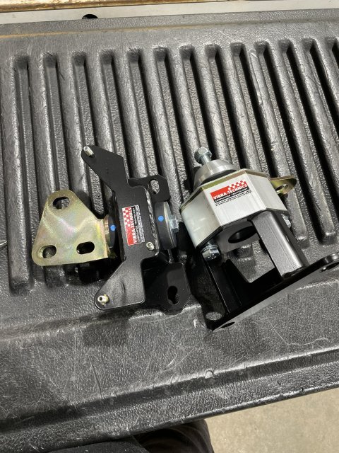

Just got these in. Hope to get them swapped this week. They better be an upgrade. I currently have the poly inserts on both sides. The car is awful when the AC is on. Wish the ECU would idle the engine up a couple of hundred RPM when the AC is under load and the fan is on.
