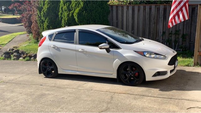

thinking of getting the H&R springs simply because it seems to be one of the ones that drops the car the most. would anyone advise me against making that decision? would mountune,eibach, or cobb be a better choice?
curious to hear what other users that have installed the H&R springs have to say...
I just got my H&Rs on last weekend, they do have the most drop! That I’ve researched, not really wanting a big drop, I was going for the gap in the wheel well, it is a rougher ride that would be my only complaint, looks great and the handling is really great, personally I’m just saving up for Billstien pss10
