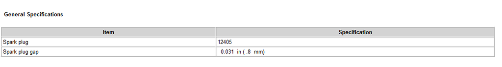

We found the OEM specification for the spark plug GAP
what is the best gap plug to set? is it the factory recommandation? 0.031?

I'm basically at the point in my 91 octane tune with MAP where a colder plug is needed to prevent negative corrections during my logs. I'm going with NGK 6510 plugs with .028 gap. There are lots of reasons to change to colder plugs and gaps

The NGK 6510 plugs are shorter than the OEM plugs. The gap on the OEM plugs was .031. I gapped the NGK plugs to .028. No difference in starting or running that I can tell.
