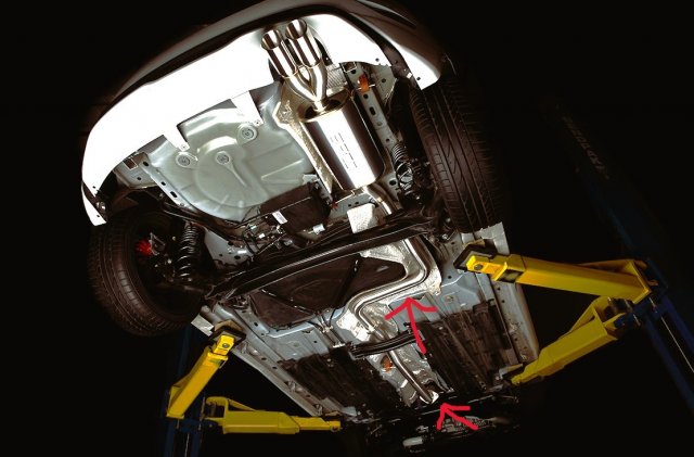

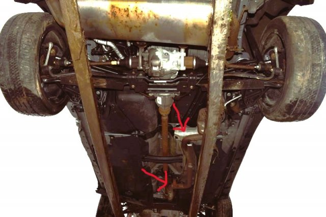

I took a look at the underbody of an Ecosport 2.0 (the AWD one), and it seems that other than the substitution of a rear axle beam for a crossmember, and the modified gas tank to accommodate the driveshaft, there's not a whole lot different. What I did highlight, however, was the difference in exhaust placement. I noticed that there were two different manifolds for the Ecosport (one for the 1.0 and another for the 2.0). I thought it was simply because they were different blocks, but looking closer at the bends, it seems that the catalytic converter is more offset to the right on the Ecosport than it is on the Fiesta. Additionally, the exhaust mid-section is hugging the frame rail and resting to the right of the rear chassis brace from the factory. Below is a picture of the Fiesta's underbody:
Notice how the bends coincide with the exhaust shield present on the Fiesta (one long bend and straight to the downpipe), while there is additional shielding on the underbody of the Ecosport to which the exhaust DOES NOT coincide with the shielding present with respect to the Fiesta (two separate bends to join the catalytic converter's flex pipe). Besides purchasing the crossmember, control/trailing arms, and knuckles from the Ecosport 2.0, it seems that getting the exhaust will also be beneficial. A custom downpipe seems like it'll be required. Luckily I have a spare catless downpipe to sacrifice. Suspension geometry doesn't look to be too terribly different from one another, which will certainly save some coin on this endeavor. Maybe the Ecosport 2.0's gas tank would also bolt in, but I rather relocate the tank to the trunk so I have easier access to utilize an upgraded fuel pump for my 4-port.

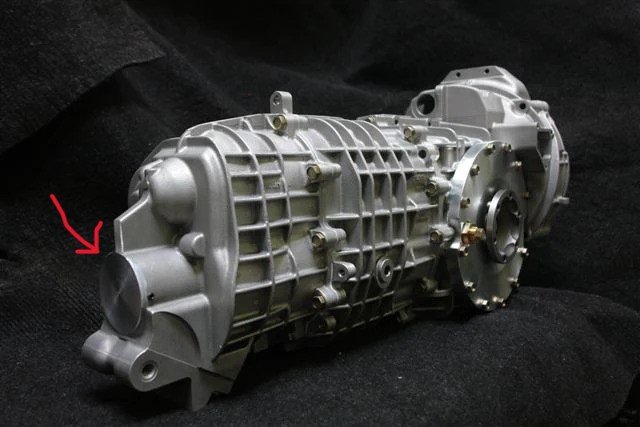

Once I were to get the rear suspension situated, I'll be looking into transaxles to see what the best option is. Considering the title of this post, I'll be trying my original route in purchasing the 5-speed transmission from the Evo and taking it to a local CNC shop to machine custom output shafts, an adapter plate, a flywheel, and a blockoff plate for the deletion of the driveshafts (similar to the blockoff plate make for Porsche transaxles pictures above). (I'd continue to run the car FWD until I can figure out the best route for installing the driveshaft(s), differential, and rear axles.) Lastly, I'll be taking a visit to a transmission shop to get a custom carbon clutch pack installed.
