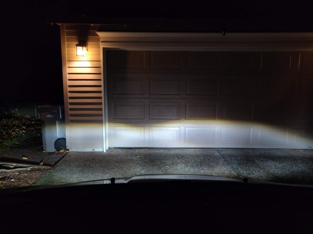

OK, here are the pics! Very unscientific, I tried to get as far back as I could in my driveway but am facing downhill and only about 15 feet away, so keep that in mind
JUST headlights for reference....

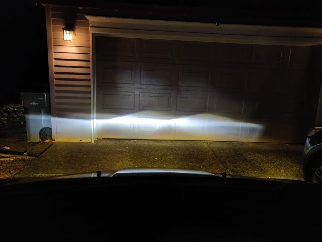

With white fog added see how it blends in with the headlights while giving the same color light as my LED headlights but adds coverage down low without added high glare:

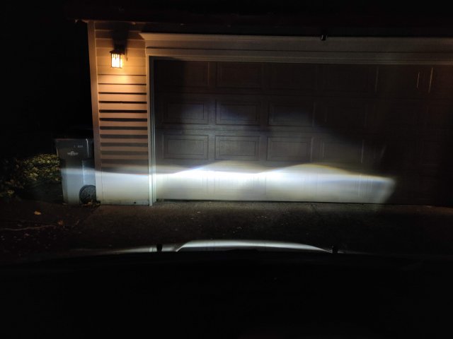

Just white fogs! Yes, I WAS able to drive in complete darkness with just these, but obviously not recommended! :)

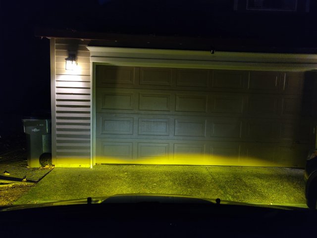

Remember I am facing downhill, with Yellow fogs only.... notice how they shoot lower than white. I put the aiming screw all the way facing down to get the white that shoots higher and blends in with headlights and yellow shooting low

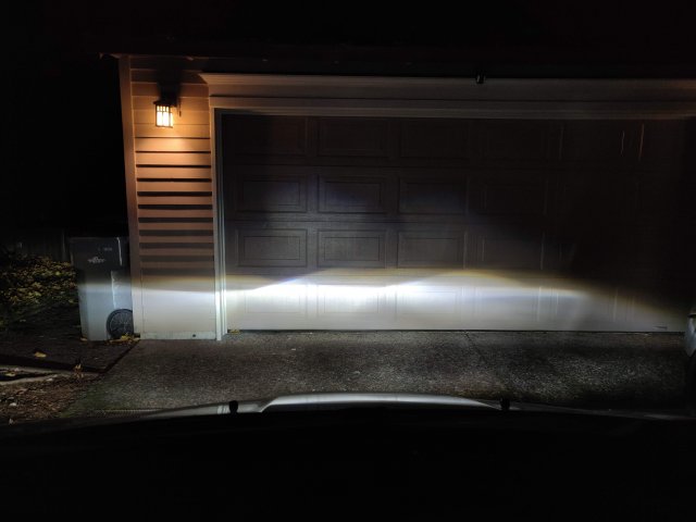

And lastly, headlights with yellow fogs:
