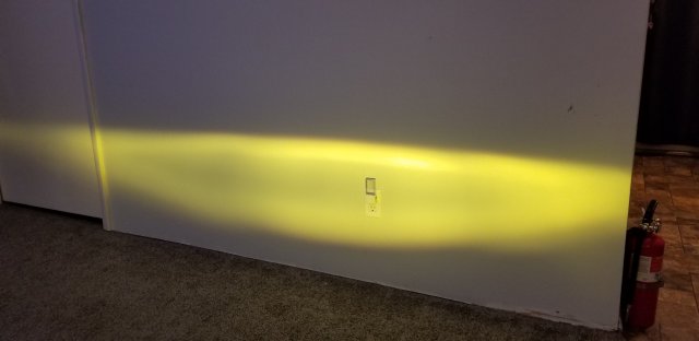

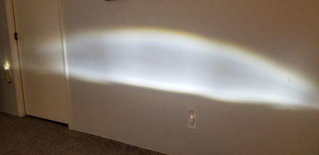

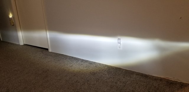

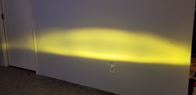

Well the iJDMToy LED Fogs came a lot sooner than expected and I installed them today. I can confirm the adjuster should be pointing down, how can I be sure? I fired them up with a 9 volt before installing them in the car. When the adjuster is pointed down there is a nice horizontal cut off line at the top and a round shape of light at the bottom. This applies to the white and the yellow. You can see in the pictures what I mean. All pictures are sitting on the same coffee table in the same place. The only difference is whether the adjuster is pointing up or pointing down.
Here is the nice horizontal line with the adjuster pointed down.
Here is with the adjuster pointed up.
Here is adjuster pointing down in yellow
and the adjuster pointed up in yellow
Just got a set of these - and when you say the "adjuster pointing down", I assume you mean the adjustment screw head should be on top of the housing with the screw body pointing down? It seems obvious, but just wanted to double check - I plan to install these when I find a warm evening. Thanks!
(deleted pics to save space)
Thanks for confirming! After a lot of thought, I WAS totally concerned that having yellow at the same exact clean cutoff height as my headlights will just clash the 2 colors together... Yes, for actual FOG use, that is what you want for visibility so that's why they are set up that way, but I like to use the yellow for looks when it's not foggy mostly... You could also have them aimed a bit lower so the yellow is at least a little lower than the white headlight cutoff but that means having them cranked all the way so then the white would be going straight into the ground and useless, so not sure what to think... do you have any wall shots since you got them installed so I can see the cutoffs?
