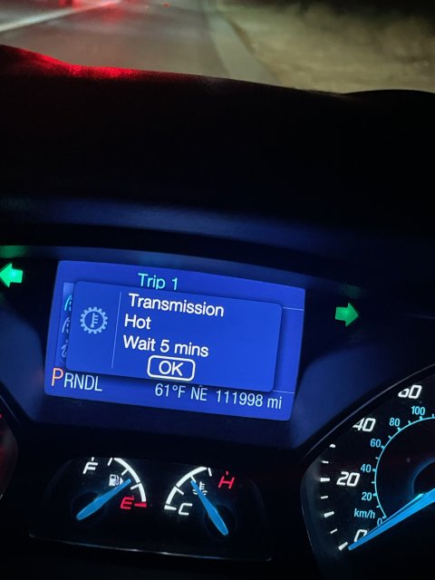

My son was given a 21013 Ford Focus, his uncle paid for a new transmission. My uncle was given a recall the Power Module.
So my son went to the dealer to have the work performed prior to the car turning 10 years old and less than a 100K miles on it, the dealer told him that they would not perform the recall work on the car. He was driving back at night and the warning light came on for an Over Heating on the Transmission. The car now is over 10 years old and had more than 100K miles.
Any tips or suggestion would be appreciated. Former owner of a FIST that was stolen. Regards 727322579.jpg

Recalls are required to be covered free for 15 years. Here's what Consumers Reports says:
Are Recall Repairs Free?
Most of the time. Federal law requires all safety recall repairs to be provided free of charge on cars that are up to 15 years old. That’s counted from the time the car was sold to the first owner, rather than based on model year or the date of manufacture. But if your car is older than that, it doesn’t necessarily mean you’re out of luck, says Wallace. “For cars more than 15 years old, automakers and dealers will often voluntarily provide a safety recall repair free, so we encourage you to ask,” he says. For example, a large airbag recall in 2020 included millions of Honda, Isuzu, and Mitsubishi cars from as early as 1998.
If your car is 15 years old or younger and a dealer refuses to perform a recall repair or tries to charge you for the fix, Wallace says you should contact the car’s manufacturer and let it know.
6,197
5,833
That used to happen in my 2012 Focus if I was sitting in a traffic jam too long . It would go away if you sat for like 5-10 minutes and the transmission would just function like it always had. It did not happen all the time just occasionally . I just chalked it up to a quirky trans as I had already had the TCM replaced once under the recall and it was my Lyft/Uber car so I considered it disposable. I bought it with 33k on it for $7200 in 2017 drove it for two years made a shit ton of extra cash with it and put 40k on it and sold it for $5600 lol in 2019.

We have an appointment for tomorrow at our local Ford dealer for the transmission. They stated that they have to have a check engine light on, and it will take 3 days to do the diagnosis, and they want 250 dollars for that.
Does this sound correct? Or should we wait for the check engine first. Thanks again

Ok thanks, I think they used the term Customer Satisfaction Recall.
Is there an illusive engine code they. need to see before they will do the service?
Jabbit
2,240
2,897
New England
Is it a Fusion or a Focus? Run the VIN in a recall checker and see what's open. They just extended the Focus TCM recall for a few more years, my 2012 was covered.

I have a 2012 Ford Focus sedan with the DCT. Did they say WHY they wouldn't do the work? You should be covered for a TCM at the very least. They did tell me I had to pay $100 diag or something if it wasn't the TCM, they should be able to check for stored codes. To be honest it's a junk car, don't invest too much $$ into it. If you are feeling adventurous you can do a manual swap for under $1k and the car will last forever.

Quote your Focus is 2014 or later with less that 150.000 miles
So the rub is it is a 2013 model and my son brought it in to the dealer and they refused to do the work, the other problem is my son did not get a receipt from them, Yes he did not listen to me, weird right, so now the car is past 10 years old, the transmission has already been replaced.
Is this DIY pricing?

Yes that's what I meant by feeling adventurous. It's a no-brainer swap if you can do it yourself; to pay a mechanic to do it, not economical. It's fairly advanced and not everyone has that comfort level, I understand that. No fault at all in trying to get the auto trans functioning again.
