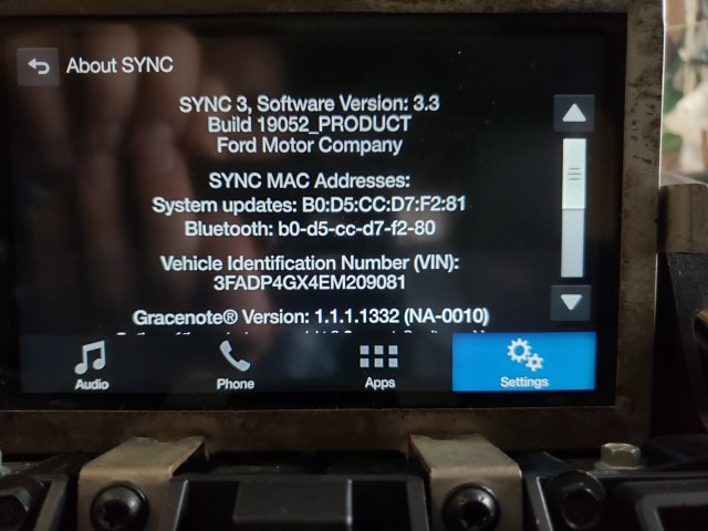

It looks like you lucked out with a 2017+ screen - the 2016 I have won't update to Sync 3.3, I'm stuck at 3.0.
Do you have the split screen? I can't get my CarPlay to show up in 3 boxes which I'm now thinking is related to version 3.3.

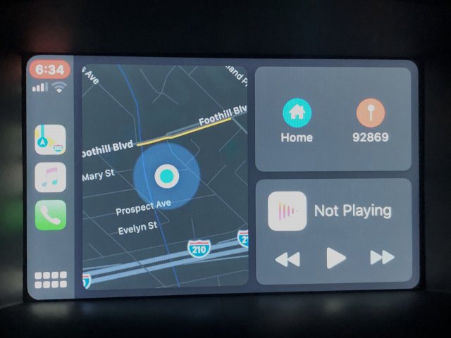

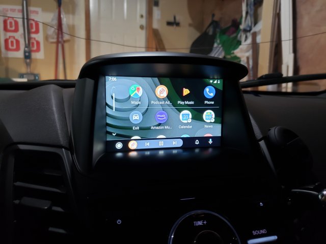

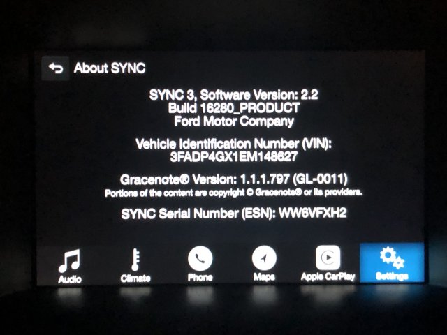

Isn't CarPlay's new 3 boxes Home Screen dependent on iPhone with iOS 13? It shouldn't matter what version Sync 3 is installed. I am on Sync 3 v 2.2 and the new CarPlay features work. Unless there's some bugs with v 3.x. My 2014 was also upgraded from the My Ford Touch and you're right that it's like driving a new car :)
View attachment 24631 View attachment 24632
[emoji848]
So what you’re saying is I should update my phone??? Ha!
I’ll give that a try!
