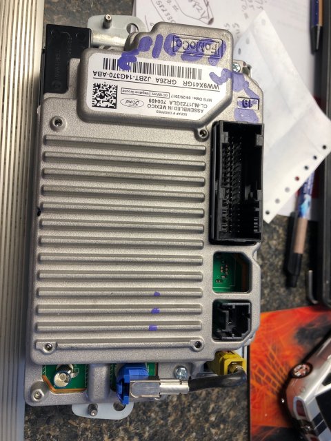

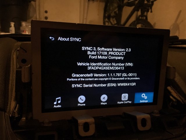

Just wanted to update. J2BT-14G370-ABA (NON-NAV) also works, off a junker 2017 SE I believe, I still have to update the firmware and program the VIN but it works!! Junker had it listed as screen only and i called and they said it was both screen and APIM with the cable, and were nice enough to send me a picture. I got this thing for $130 with shipping, the new hub was about $28 off ebay, and i was lazy and didnt want to pull the console off so i opted for the plug and play adapter for the hub ( i believe this one was a Sync 3 Gen 2b) for $15 off ebay for a whopping total $174. This thread definitely made it easier so hats off to the OP!
What did everyone that swapped do with their old unit?
View attachment 24892 View attachment 24894
Kept it incase this all went south! ha! I think I am clear to chuck it now...
