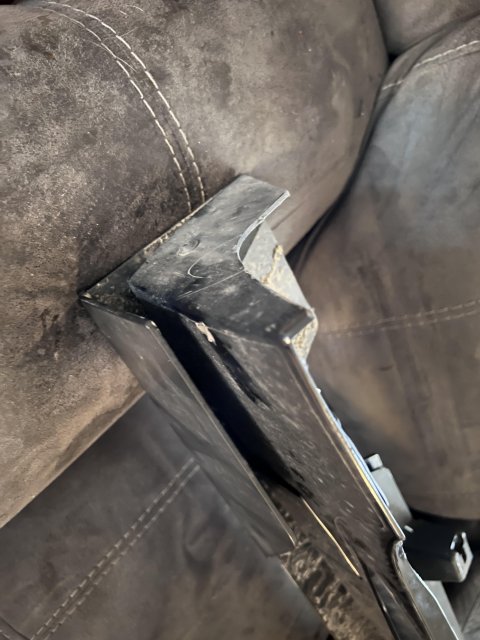

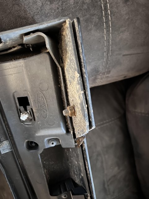

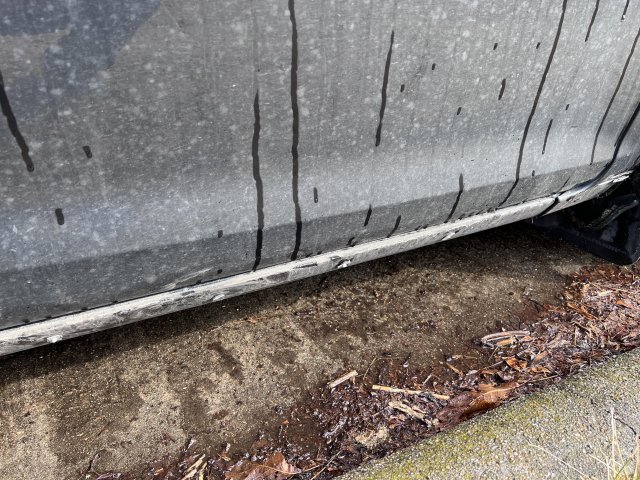

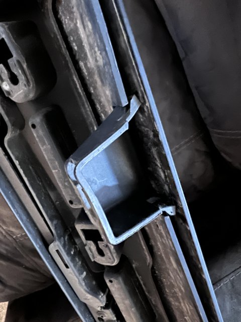

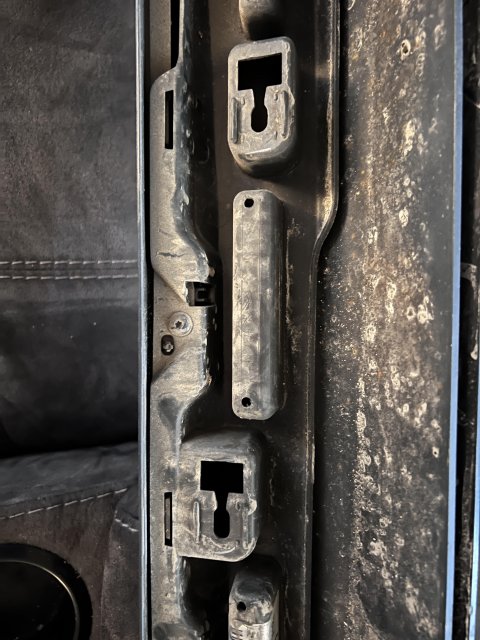

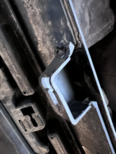

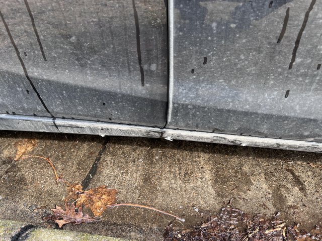

I figure since this thread is on body work i would show the skirting issue too rather than make another thread. When i got my tires put on yesterday they snapped off the rocker moulding as they were backing up out off the lift. I couldn't see that side of the car so i don't know if they messed up and they told me it cam off due to the freeze we are in which is just thawing today. I planned on replacing them anyway so i didn't push the issue but im still a bit miffed, this is the 2nd time body damage has occurred at an auto shot due to a lift catching on something.
Anyway here are some photos of the car and moulding. Whoever had it before me added what looks like a rally type splitter, bolted on, which i had no idea till now, i thought it was all one aftermarket piece. Just figured i'd put these up to see what you guys think of the damage. The lower panel of my car doesn't look damaged but the clips are pretty mangled and some of the plastic on the rocker moulding is snapped where the clips attach. Just wondering if you guys think this is salvagable or will i need a new moulding. Im gonna remove the splitter today just to get a better look at the stock piece but anyway here it is.
Passenger side with two photos. Looks like clips stayed in but most are pretty mangled.

Next two show the underside clip slots on the stock moulding. The plastic has a lot of give and looks to be cracked pretty bad, i doubt they are very secure.

Last photo is the clip slots for the side of the car in the first photos. These look to be unaffected and perhaps with new clips, enough to secure the moulding even if the lower ones are busted. Or is that a bad idea? By my count there are 9 slots and all appear to be intact, while the 3 for the underbelly of the car are pretty busted. Thoughts? FWIW im taking off these heavy splitters if the moulding can be reattached so it will be a good bit lighter.

#1 they are 100% BS’ing you regarding this freeze/thaw cycle causing the issue. That excuse is laughable and I’d love to hear them lay out this line of thinking. They owe you at minimum the clips and labor to get the car back whole if not an entire new molding. I’d get with management there and see what happens. They know they’re lying and are probably not the brightest do hopefully they’ll do the right thing. If not….
#2 Your rocker molding looks mostly ok, just needs new clips and maybe some soldering iron plastic welding. I replaced the drivers side on my wrecked fiesta. There’s a thread on here with the clip part number you’ll need. Put the clips in the molding and then press it into the car for best results. Looks like you’ll need the hardware that attaches up by the wheel too. Look at a diagram on a ford parts website to figure out what you need.
I was thinking the same, I think they were just careless. I used to work at this company’s tire warehouse and they are less than honest, the owner is a real D bag. I wonder if it’s worth contacting a small claims attorney? I hate legal stuff though, this is an annoying situation.
