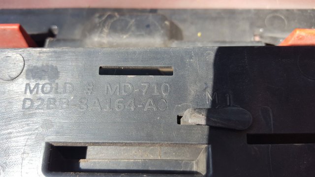

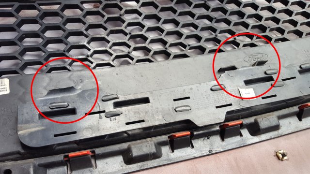

Took the bumper off to secure the charge pipes with new clamps. Managed to develop a fitment issue *somewhere* that didn't exist before today so there's now a small gap under the front part of the headlights and the hood/bumper gap is slightly larger.
Finally got around to figuring out why my FiST #2 had the gap.
alignmenttabs-broken.jpg alignmenttabs-broken2.jpg alignmenttabs-broken3.jpg alignmenttabs-broken-partnum.jpg
If you look through your grill and your tabs are missing, that be the problemo

It comes off. I am just going to trim some abs, heat to bend, and attach it to the existing piece I removed. Then shape some aluminum to line the bend for structure
Here is something that someone with a 3-d printer should make! Replacements for those who break them! Where is SirThomas88 at?
