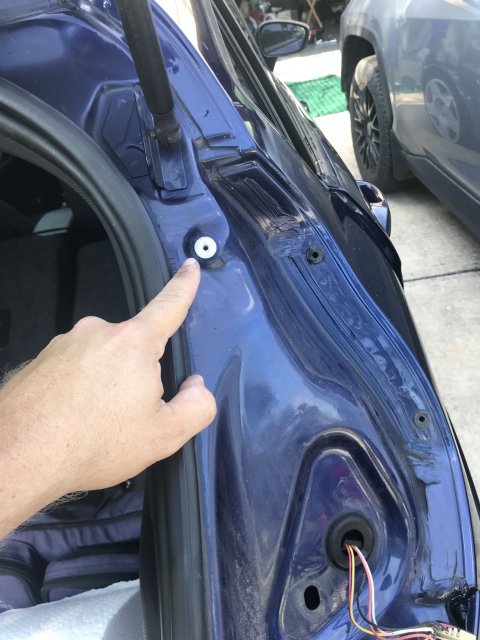

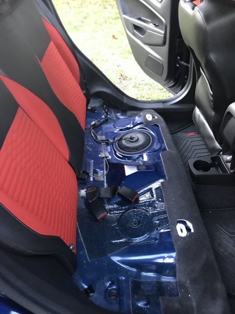

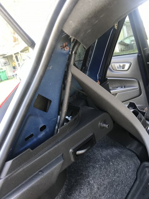

Found out I have the common rear hatch leak problem. Took the back of the liner apart and checked the sunroof drains. Thankfully They were clear. Looks like water was coming in from behind the tail lights. It’s crazy ford covered up holes that water could get in with just tape! I put new duct tape over the holes using the shingle method and put some sealant and thread sealer around and on the twilight screws. So far no leaks!

i need to do this
is there a thread that outlines this method/

i need to do this
There is a video on YouTube called the ultimate fiesta water leak fix. Or something like that it’s a excellent video he shows everything
