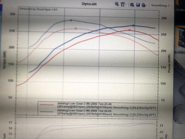

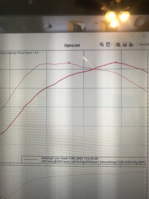

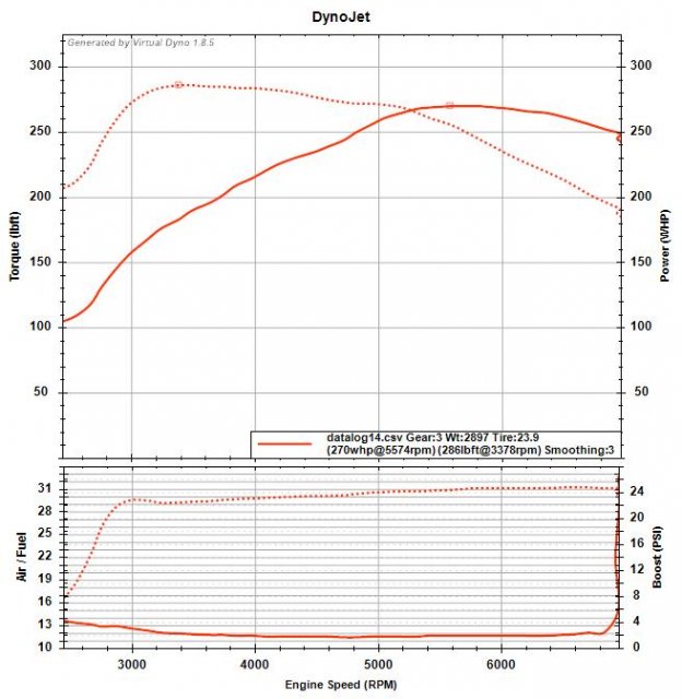

Here is a v dyno on e30 I did with this turbo. 267hp 267 tq. During hot summer weather in Florida. So I should see alittle better numbers this fall. I think the Power and looks pretty good.
Hes on smoothing 1 and his peak is a blip further up in the RPM range. Try switching your smoothing to 2 or 3. It would clear that and give a more accurate torque and boost peak view. Would probably put it somewhere between 3k or 3.3k

#67
From the little bit of the boost graph I can see down the bottom...your boost curve is much more linear and not as sharp as on my whoosh... When you made that pull did you punch the throttle or ease into it? I would log one and make sure I punch that throttle pretty sharp

Thread Starter #69
We have the same tuner...slightly different hybrid set up
Yes it has a nice linear power curve. I’m thinking injectors will be a big help for this turbo since it makes power higher in the rpm range.
I went full throttle in third as if I was doing a log for Adam.

#70
That really doesn’t sound right to me for such a small turbo. Ask Adam if it’s possible to bring the torque curve lower into the RPM range.

Thread Starter #71
The turbo has a big turbine for a hybrid turbo. I believe this may be the reason for the power being higher in the rpm range. Honestly it’s not bad. It’s not like it’s laggy. If I floor it at 3k rpm it goes immediately. It just keeps adding as the rpm goes up. I just wish it was making alittle more power.

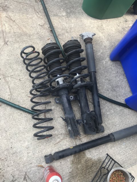

Thread Starter #72

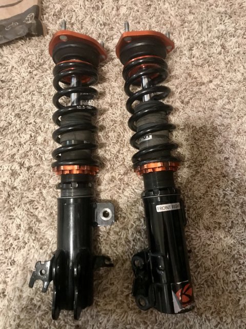

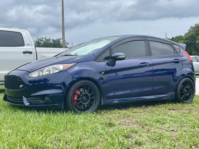

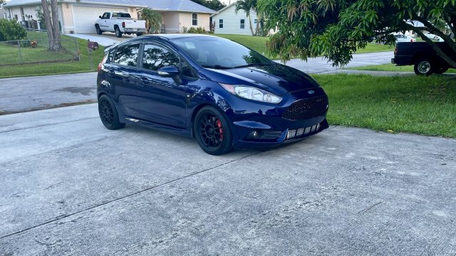

New coilovers, wing extension,rainguards and st gel badge installed! Car is looking really good now. I have the whoosh rear spring bushing coming in. I’ll install those then get an alignment done.

Thread Starter #73

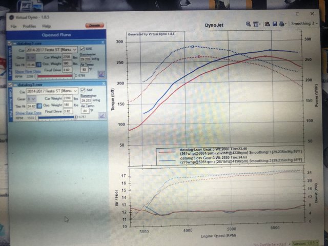

Update for you all. I traded my fifteen52 rims for some konig hypergram rims, 17x8. It saved a lot of weight. I then did a quick vdyno run and the numbers are looking a lot better! Gained 15hp and 25 wt. (according to vdyno) She feels more peppy now. I plan on painting these rims white. I’m really happy with these results and the turbo.(vdyno runs shows before and after. Red is before blue is after the rims)

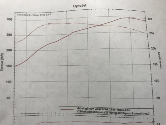

Another update for the turbo. I got new tires, cooler weather and a new vdyno run. I was able to hit 298 hp! I did several runs all were similar. Very happy with these results and this turbo. The car pulls hard. Also I was able to beat a is300 with a supra motor swap. It was on stock turbos. I want to get a real dyno run sometime in the future.

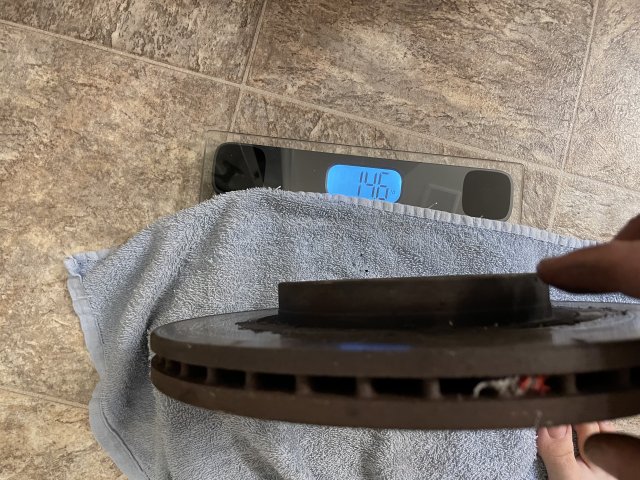

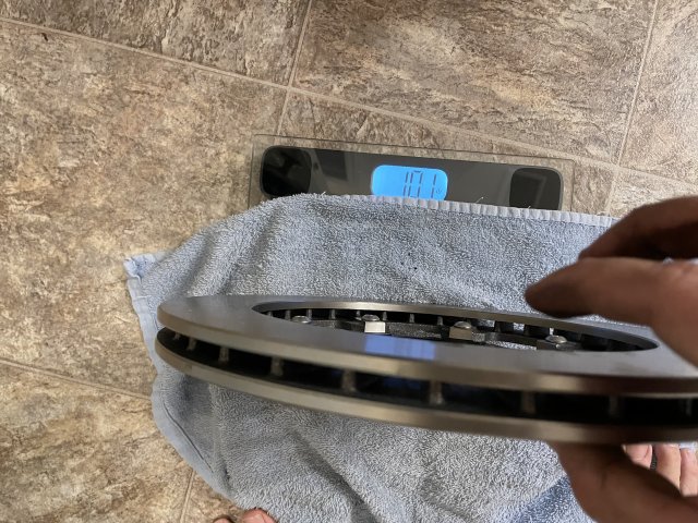

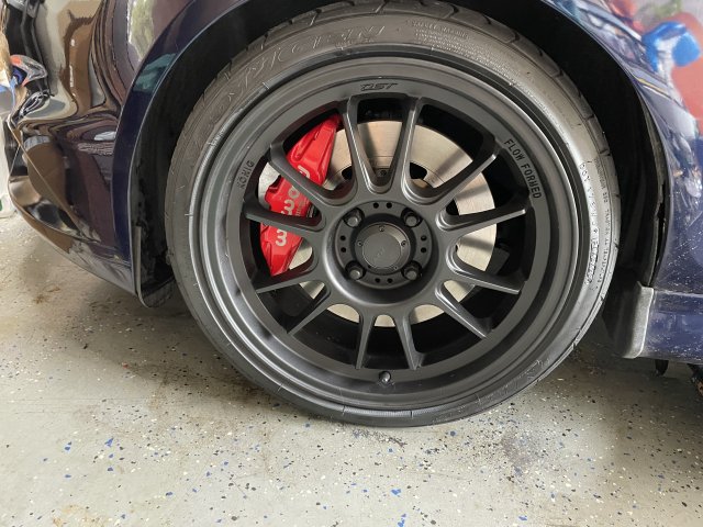

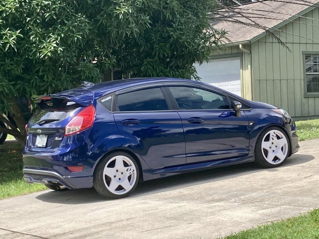

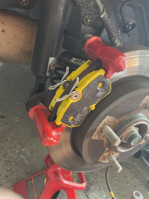

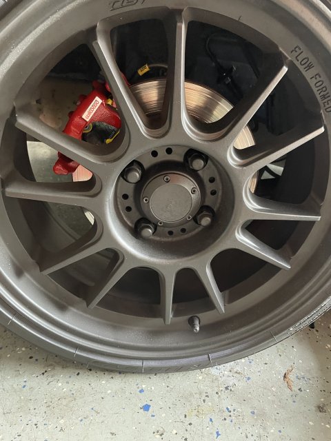

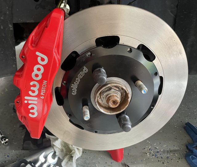

It’s been awhile but I have some more upgrades! Painted rims black and installed Wilwood big break kit. The rotors are over 4 pounds lighter per side. They feel awesome

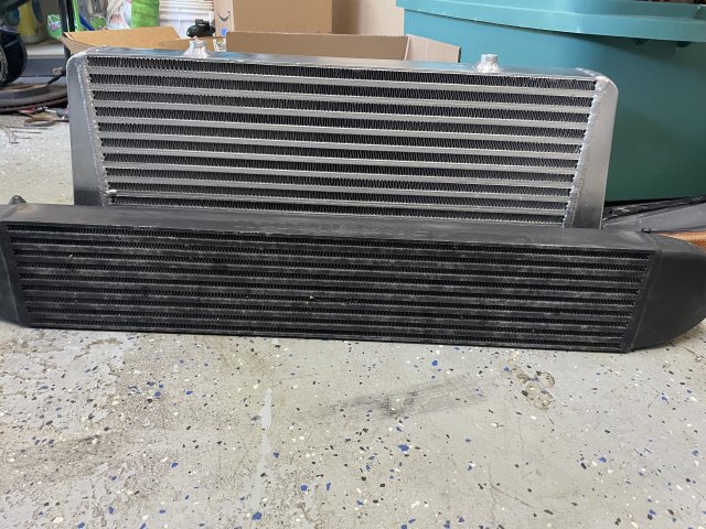

Thread Starter #77

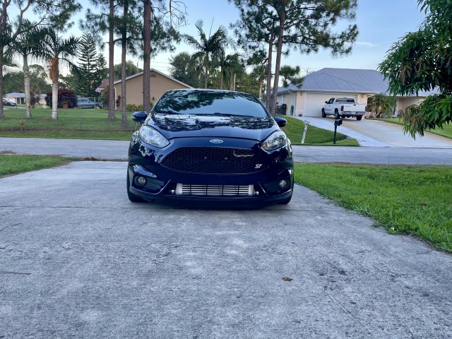

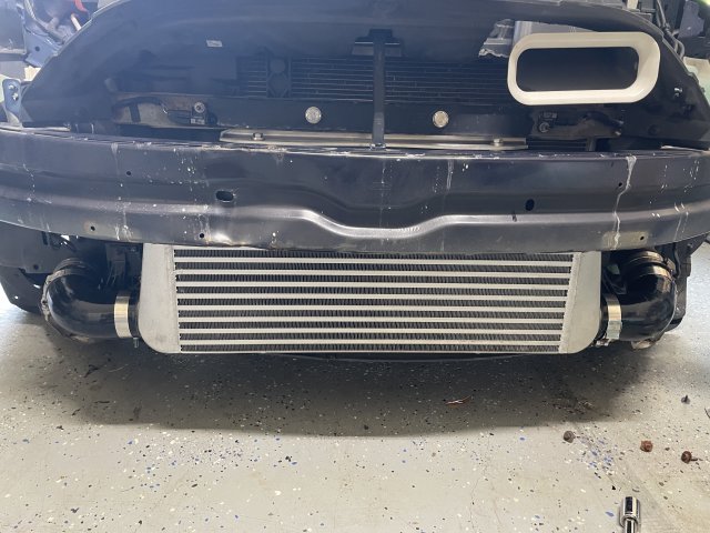

Installed SVT design and fab front mount intercooler. This thing is massive! Showed compared to the mountune intercooler
(which I will sell if anybody’s interested)
She’s getting ready for a track run! I’m thinking about going to the firm in north florida

#78
The FIRM is a cool track, I like following all of Grassroots motorsports lap time tests there.

129
Thread Starter #79
Yea I wish it was in one of these racing sim games so I can practice it lol
