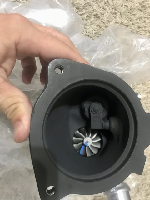

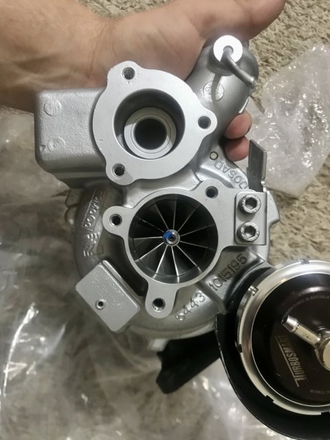

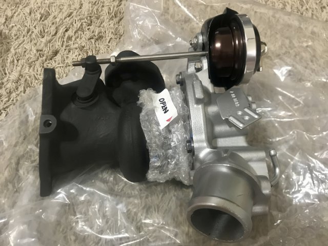

Got the turbo back in! It looks great. It was rebuilt by turbo bay with their upgraded parts.
I will be installing it tomorrow (hopefully)
I wonder what they upgraded? Maybe this should be the x48 build! Excited for you man. The install should go well seeing as you installed it once already.
Yea it’s upgraded internals. The wheel looks bigger and has more fins on it. It will be interesting to see what kind of power it can make

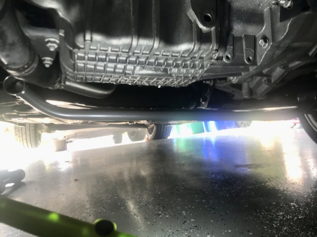

i also just installed the 2 point lower chassis brace. The car is gonna be a totally different animal soon!
How was the install on this? Probably the first piece of aftermarket bracing I'm going to get. Seems super straightforward.
Yes It was really straight forward. Just need a breaker bar that you can get under the car to break them loose. Torque the new bolts to 45ish pounds then go another full turn. I already noticed getting better traction in second and car seems more stable.
Nice! Appreciate the insight. (y)
I found the car feeling much more firm on turn-in with this simple mod. The front really started feeling more connected.
