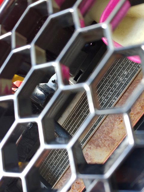

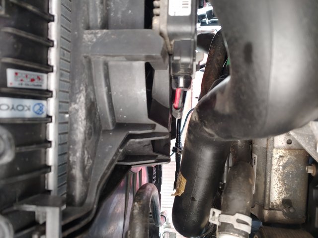

20200321_161045.jpg 20200321_160439.jpg so ive noticed i dont have the air shield that channels air into the radiator. Or the foam on top of the radiator. Also the cooling fan was not plugged into the module. For like a month, with rain and shit. First time ive gone under the car since i got it back. Idk if my fan works.
Good news is i re loaded my AP. On stage 2, did an oil change and new oem air filter.
