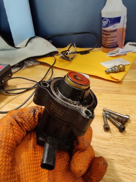

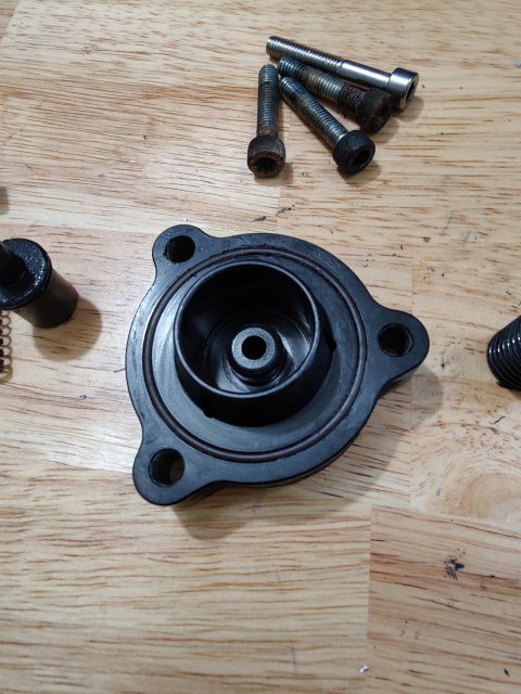

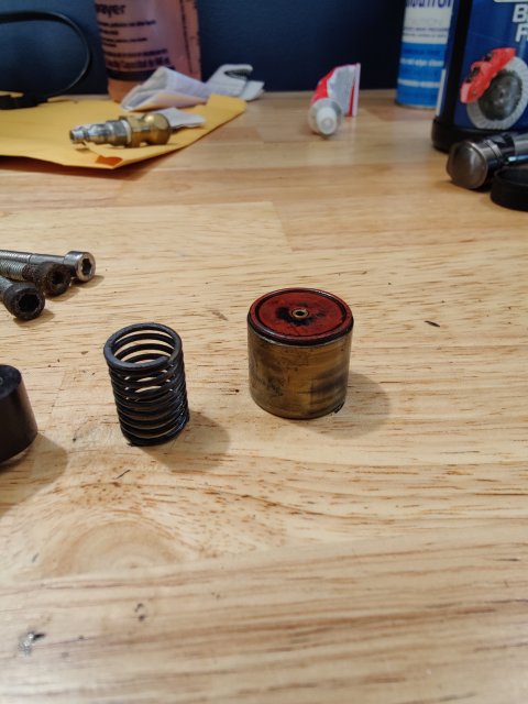

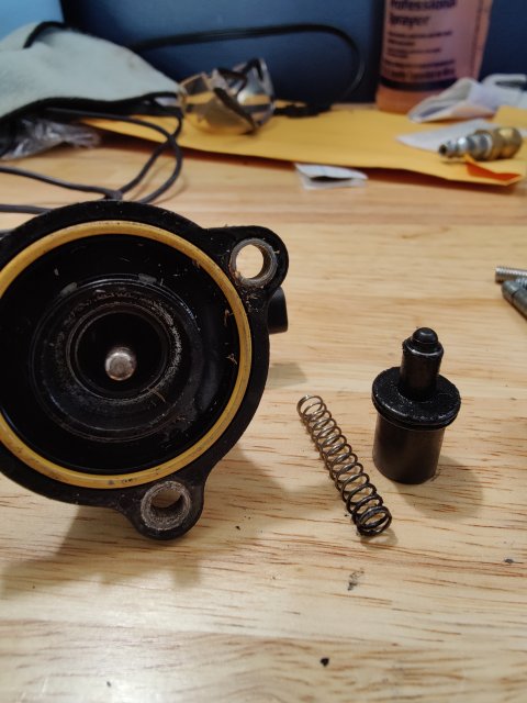

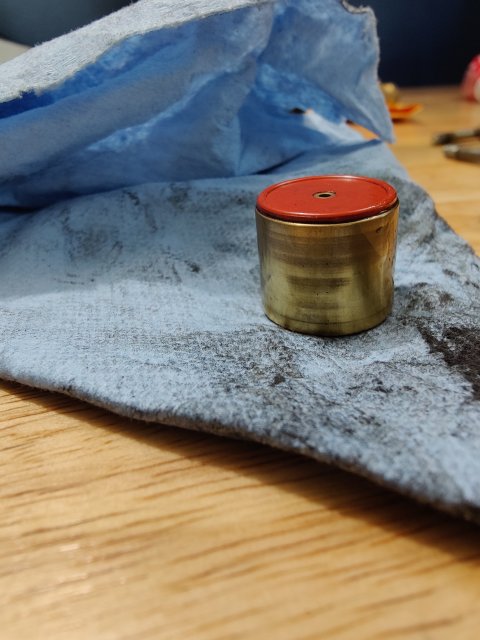

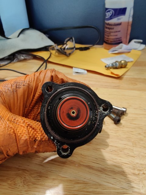

Finally wrestled the thing out. First thing I wanna say is NEVER AGAIN. You can judge for urself from the pics, but I don't think it needed the maintenance. Not so much so that makes it worth the absolute curse fest it is to get the bastard out...and then back in lol
There's some wear showing but the piston was still smooth in the discolored areas when I re-lubed it so all good.
One thing of note is that the whoosh replacement screws advertised to work for the GFB don't...at all. They're tooooo long and bottom out (so much cursing). Notice in the pics the length of the brand new screw vs the GFB units. I reused the screw i stripped... pure luck. Thanks Ron. Hope he takes them back and pays for shipping!
Originally installed November 2017 with about 22k. I'm at 61,400 so ur looking at about 40k miles, with Strat tune.
