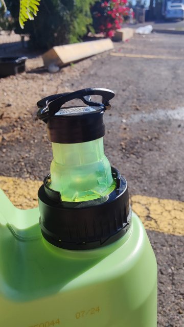

If you wanna go green, I recommend Molygen😉
:LOL:
IF I could know for certain that stuff used a mostly group 4 (PAO) and partial group 5 (POE) base stock, I would have kept using it.
But LM will not say, and no one else seems to know what they use, and claim it is just hydrocracked group 3 base stock with their Molygen additive.
