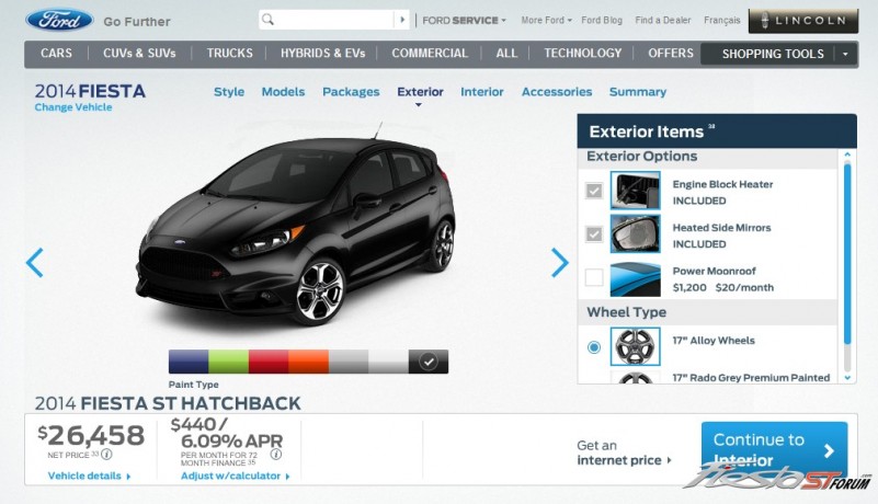

So does this mean, we all have the heater in the car, just need the plug?
In the US, its an option from the dealer. In Canada its included.

I swear mine did not have this option... Weird. Should be ok without it but it would be nice.
Yeah that was the Canadian configurator. Its not even listed on the US Ford site.
