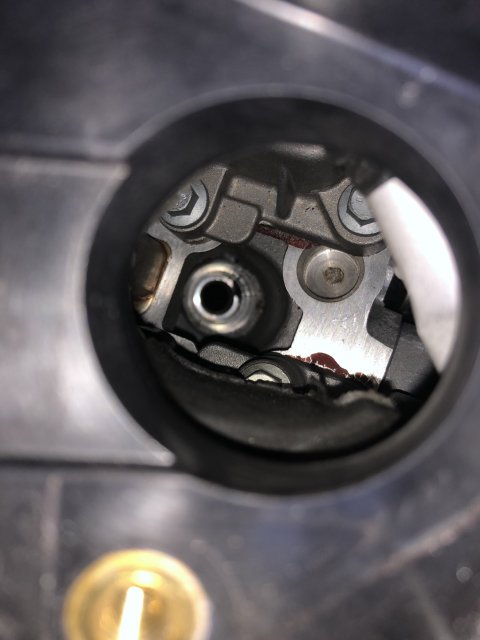

Update. I took out the Colder plugs and swapped back to the OEM ones (thankfully I kept them). I didn't see any coolant during the process, but I did see what looked like a little dirt. See attached. Any ideas? Also it seems to be starting a bit more smoothly.
