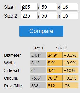

So... how often do you hit redline during an autocross? I was reading a article about running a fatter A052, but slightly taller. Their conclusion was the 0.8% higher gearing cost more then the 20mm extra width of tire.
https://www.turnology.com/tech-stor...V9nlh41IH2-hnRQek68oWAmlqn8lNlNjfF2je6ZkAB_lc
After this event, I wish I had the taller tire, I already am on the RE71 205/50R16, so taller then the taller tire in this article by 0.4%.
Im guessing this layout was an anomaly. What have you experienced?

I can understand that concern, but the tallest tire I am seeing (in 16" that could/should fit), the A052 in 225/50R16, would only raise the car 0.4". This isnt insignificant, but if these cars are that close to rolling over, then they shouldn't be competing.
But then again that difference in size only equals 1.7mph at 50mph.

Thats another 1/2" taller of a tire then I am running (205/50R16), so 2.1". Its giving you another 1.2mph at 60mph.
Compared to stock its 4.7% taller, so 2.8mph at 60mph.
Any issue with feeling more high centered with the taller tire?
