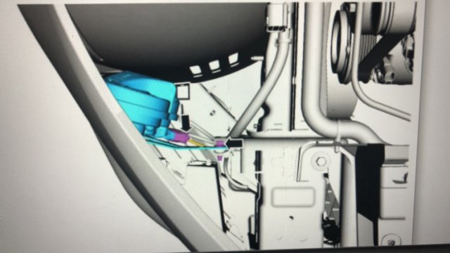

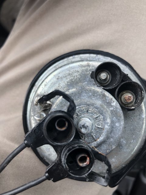

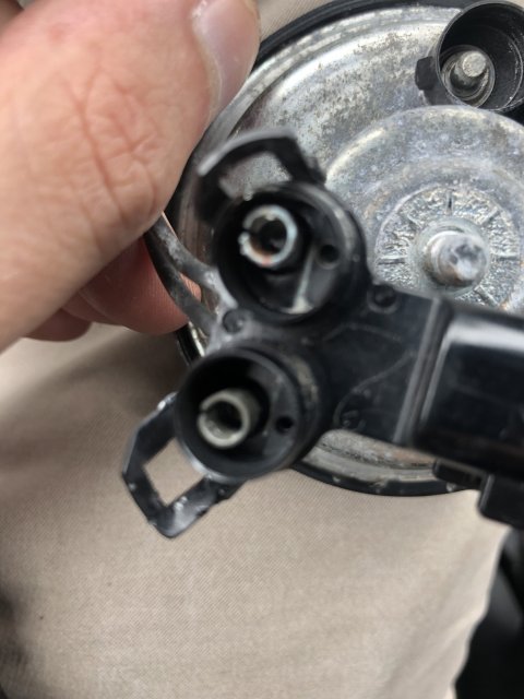

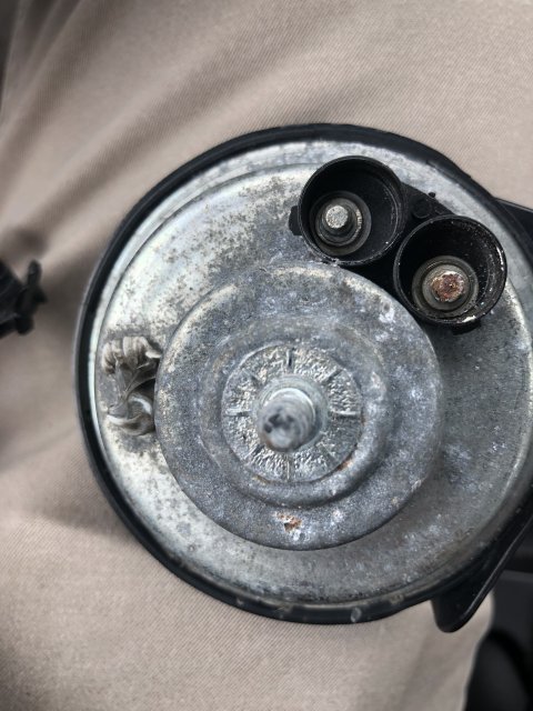

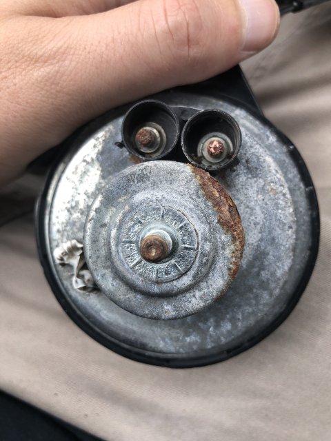

The caps that connect the two horns in series were the flaw in mine the terminals inside got corroded to the horns themselves.
check the fuse (26 per my fuse box but there are multiple ones on this car). In my case the relay/bcm was clicking under dash so I knew the fuse was good and horn switch circuit and clock spring were good.
