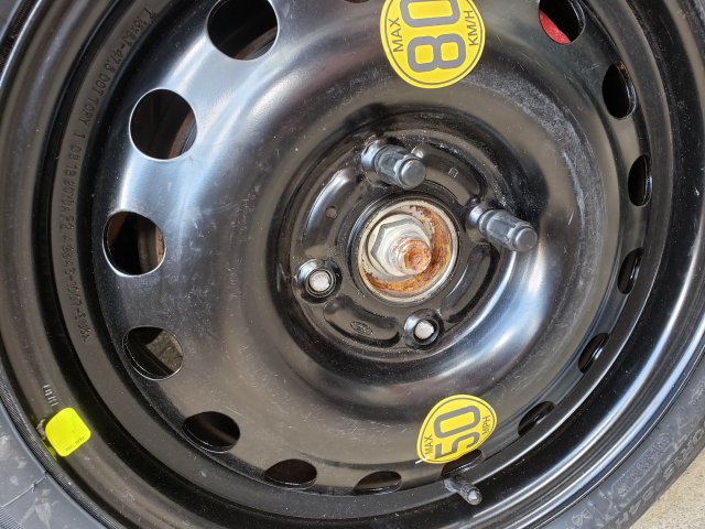

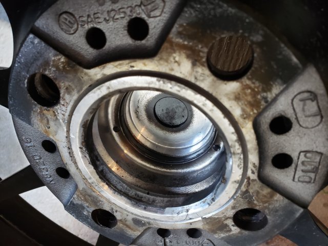

I was driving to work this morning when I hit a very small bump and the right front tire started to thump a bit on rotation almost as if it were flat. I pulled over to inspect, no flat could not find anything loose. I suspected that perhaps a camber bolt had loosened and limped in the mile or so to work. After work I noticed a broken stud and missing lug nut. Upon trying to loosen another stud broke. This was nearly a very bad day for me.... I got the tire off to find that the hub centric ring was slightly cocked in the bore. I've been running these Dekagrams since May and have put nearly 1000 miles on them including an autocross. The studs were properly torqued and the two remaining were still very tight. Has anyone had this happen? Anything I could do to prevent a recurrence?

20200811_163909.jpg 20200811_163853.jpg 20200811_163844.jpg 20200811_163909.jpg 20200811_163853.jpg 20200811_163844.jpg

I think you have the cause and effect backwards. Most likely the studs failed and as a result the imbalance in pressure caused the hub centric ring to shift. The hub centric ring has no role once the wheel is bolted on. It's only there to position the wheel completely centered until the nuts are tightened.

Thanks for the feedback, I've been thinking about it and the lug nuts I'm using (Gorilla Automotive 21133ETBC Black 12mm x 1.50 Thread Size Chrome Finish Small Diameter 5-Lug Kit, (Pack of 20) ) have an insert below the taper to fill the hole in the rim. I thought that would be a plus but now realize when the ring got cocked tremendous pressure was transferred to the studs breaking two of them. I might try plastic spacers and regular tapered lug nuts.

I've always thought that those type of lug nuts were what you used either in lieu of, or if you could not find the proper hub centric ring for an application, but NOT for use with a hub centric ring. [dunno]

I put them on, new, in May. Torqued to 100 ft/lbs then re-torqued about a week later. No issues until yesterday. Just odd that it would randomly happen especially since I wasn't even driving it hard. As pointed out here, I think the lug nuts I'm using aren't appropriate for the application. Thankfully it's a cheap mistake and one hopefully others reading this won't make.
