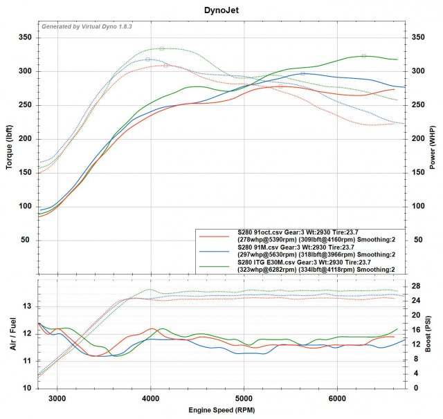

@Stkid93 What will your car be mainly used for? For example, stop-and-go city driving, highways, track, etc?
I originally ordered Whoosh hybrid with ported OEM manifold. Ron offered me a deal on a S280 and Airtec manifold because they been on backorder for a while, and I took the deal. I'm glad I ended up going with S280 + Airtec in the end because:
  • I got the car as a daily driver with a target goal also set at low-300's WHP
  • Typical AZ gas stations carry 91 oct max, and I heard that 91 oct in AZ, CA, and NV is worse than 91 oct in other states. Having a larger turbo generally allows for more power at less boost/lower quality gas. I was able to hit the low end of the target with 91 oct + WMI, and the high end with E30 + WMI on stock injectors and HPFP.
  • Bulk of my commute will be on city highways where cars usually cruise at 65 to 80 MPH if my employer ends the remote work option. While I miss the "donkey kick" of the stock turbo, this combo obsoletely rips on the highway speeds where I can safely floor it on 4th or higher gears. 1st and 2nd gears are useless for hard acceleration anyways, and even 3rd gear gets sketchy.
  • Airtec and catless DP will add back a good chunk of the "donkey kick" feel.
  • I got Whoosh V1 IC thinking that I'll end up with a hybrid. It works fine with S280 since I don't track the car or repeatedly get into boost. Thus, I don't have a plan to upgrade to a bigger and heavier IC at this time.
Below is the vDyno graph showing results from three maps (91 oct, 91 + WMI, E30 + WMI). I had Cobb catted DP at the time and ambient temp was in the mid 90's. I switched to the ITG intake and currently testing a catless DP as Adam stated that the stock intake and catted DP were hurting the spool.

there are a few people here who have had both hybrid turbos (whoosh/x37/etc) and S280s on the same car. they can be the best people to give their opinion on what the car feels like in the midrange of the revs.
i'm guessing your WHP goal is at redline and not at 3500. that said, your driving style does not match up with the hybrid turbos. those setups have torque come on fast and come on strong. although i'm still trying to wrap my head around your driving style. 4th gear i would consider a "highway" gear and if i was at 2500RPM in 4th on the highway I'd be ran off the road. and rightfully so.
i'm just saying with you preferring to drive in the 3500-4500RPM range, that's where the stock OEM turbo makes its living. the S280 will give you what you want but where it sets itself apart is it'll keep feeding you power all the way to 7000+RPM. if you feel like you're missing out on something in the 3500-4500 range then i'm not sure what will help. if all you want is power in the 3-5K RPM band i'd say stick with OEM if you can get ethanol and just get an e30 tune and work on other ways to improve your car.

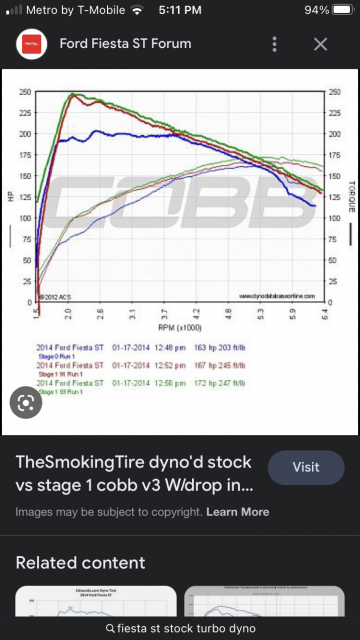

@esp_martin I’m already on e30, maybe I didn’t explain myself that well. Yes the stock turbo makes good mid range power, but if you seen dyno charts torque peaks at 2500-3000 and then drops off like a rock. (I attached a picture of a stock turbo dyno as a visual). Look at that green line, by 3500-4000 you have already lost a ton of torque and by 4500 rpm he’s well under 200 ft lbs (and is actually closer to 175 ft lbs). I’m looking for ‘more of a flat torque line/a turbo that holds that torque longer.
So as an example if the stock turbo peaks at 300 ft lbs at 2500 rpm, but by 3500 rpm it’s already down to 240 lbs of torque, I’m looking for a hybrid that still has 300 ft lbs in the mid range instead of dropping like a rock. So a hybrid turbo should be perfect no?

Check out Jeff's videos on youtube Graysxt or something like that. He goes over his dyno charts with an X47 and shows that the hybrid turbos do pull further throught the rev range vs the stock turbo if not as strongly as the S280. I thought his charts looked pretty good. He has a thread on here too but sold his ST a few months ago. His results are partly what sold me on a whoosh hybrid.

If you are doing mostly city-ish driving, perhaps a hybrid may better fit your style. It'll be nice if someone with a hybrid can post their real or vDyno results for comparison since I stright to S280 from stock.
