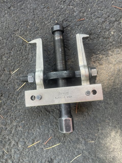

DId anyone here struggle with getting their crank pulley off the shaft? Mine is seized even with the stretch bolt removed. I'm looking at some pullers that can pull from the insider of the pulley currently.... and getting a map torch.

me. i had to go buy a 3 jaw puller, because the harmonic balancer puller that came in my useless tool kit for the timing belt job didn't fit either. 3 jaw puller was the trick, just hated to walk away from the job to get to the autoparts store.
make sure you've got the flywheel holding tool in and the butterfly on the cams, as well as the pin on the crank. even with the 3 jaw puller, i had to spin the pulley on the crank in both directions, twisting it back and forth while pulling it off. I did use a heat gun and some PB blaster before i went to the parts store to get the puller. leaving that sit probably helped as much as anything else. probably the hardest part of the job. hang in there!

this has become a pretty big situation. And I noticed the center of the crank has these divots almost like somebody tried this before and did a terrible job. They are on the outside of the crankshaft so pulling shouldn’t be a problem. I have this snap on tool that can go to the inside of the pulley which I feel more comfortable doing because I’m worried about separating the rubber pulling from the outside, but I’m not getting much leverage with it.

you can reverse the teeth on that puller to point in, right? give that a try. i put the puller jaws on the outside of the pulley and finally got mine to budge. not come off, just budge. then went all hulk on it spinning it back and forth to work it off.

I think I’m gonna give that a shot but the space is limited unless I can get creative with dropping the engine lower like others have discussed in this thread. I just worry that it’s gonna require so much force that the rubber might separate the two pieces, but we’ll see fingers crossed otherwise I might look into getting a slide puller just to be a little more safe.

Oh I lowered the hell out of the motor to get clearance. Needed to come down about 4 inches or so. Cheat where necessary.

Yeah, I think my Jack is currently not in the best location. I might have to install the pass engine mount to kinda re-orient it a bit. I still have the lower engine mount attached as well as a transmission mount obviously

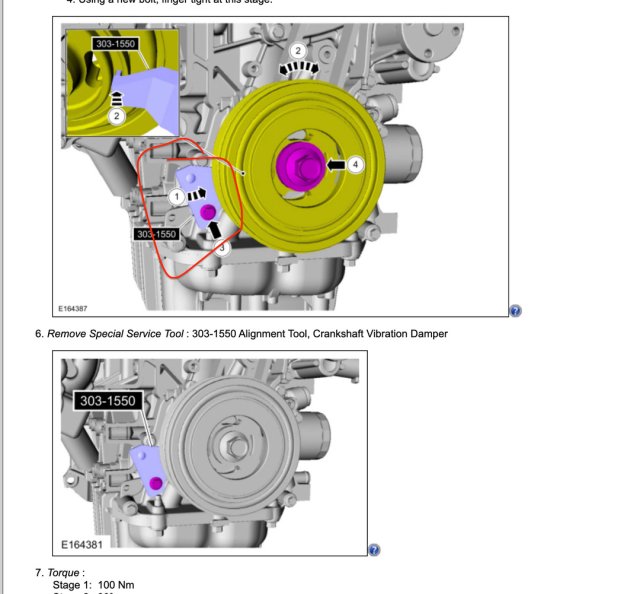

New crank pulley arrived so picking back up on the install and I seem to have a captive crank position sensor tool which make sure the crank pulley is in correct position with everything else. The manual says you’re supposed to remove this tool before you torque the pulley down. But I’ve seen plenty of people remove this tool after torquing the pulley down. Does anyone have experience with this and should I just give this thing a good pry to get it out? Or should I start over and get a new crank pulley bolt? i’m inclined to think the manual knows better but it seems odd that you would remove the tool before torquing the pulley down If you need to keep the pulley in that position the whole time.
Some how these guys managed to get it out even after torquing the pulley, no problem -

heh. yeah... that's a thing. The first toolkit i bought had one that wouldn't come out once the pulley was snugged down. I used the old bolt and just ran it down to snug to make sure the tool would come out before i torqued anything, since that bolt is a 1x use stretch to yield. I couldn't get it out no matter what i tried. Ordered a second one, and it kinda worked, once i added washers to the bolts to raise the tooth that holds the back of the pulley in place, since the crappy 2nd tool was only slightly better than the first one. my advice: get a second tool from not-amazon.
eyeball comparison between the 1st and 2nd tools i bought are noticeably different sizes and shapes.
you should keep the tool in place while torquing. you run the risk of it moving when torquing it if you don't have it in while torquing it, or cranking that 90 degrees or the second 15.

Just a heads up , I'm doing my timing belt now on my ST and the tool that goes on the crank pulley should be placed and lined up to match top end cam tool. Then pulley tool removed, again remove pulley alignment tool after finger tightening new crank bolt, then torque to stage 1 and reinstall pulley tool to check alignment. If alignment is off, restart process. Don't leave pulley alignment tool attached while torquing down. This is a double check measure to prevent what happened to the OP. I would add a third alignment check after stage 3 torque, this way you know the timing is good to go, if it's not, then you can just buy another crank bolt without going through the whole process again. Be aware you still need the flywheel/starter tool in place while torquing down. BTW to others that complained about this job, don't, until you've had to change a timing chain on a Mini Cooper, ask me how I know.

Did you use the Flywheel locking tool to hold the Crankshaft in place while torquing the Crank bolt down or did you just leave the TDC alignment bolt and torque the bolt down?

I removed the tool after marking the pulleys location with a colored marker. I heard torquing down with tool on could possibly damage the crank pulley to the point where the sensor can’t read location
