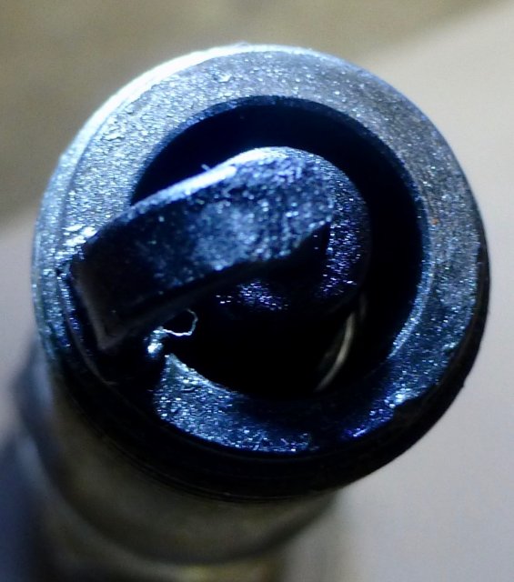

This is the best shot I can get of the ground. I do not see concrete evidence of metal transfer, but it's hard to say. The spark plugs only had about 1000 miles on them. If I try to remove the baked on oil I may also remove metal deposits. Even though I'm still suspicious of the fuel. My car may have had the head that had overheating issues. No way to know for sure until I pull the head. Too depressed to start that project just yet.

What about the other spark plugs? You are looking for tiny divots of discoloration on the ground strap to support evidence of knock (i.e. poor fuel octane). The spark plug from the failed cylinder is tough to see when it is covered in oil.

It may have been struck by a piece of piston. The other plugs have no damage or deposits all all...they look virtually new.
