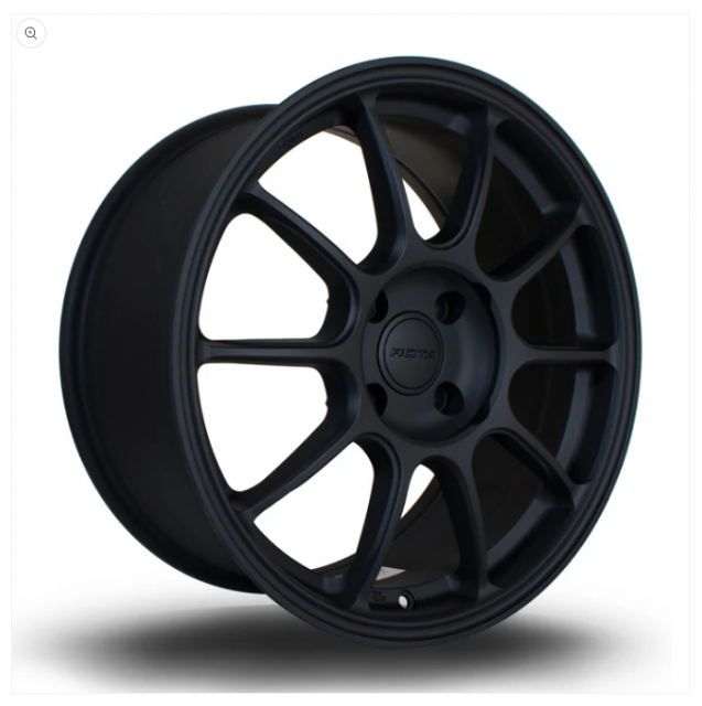

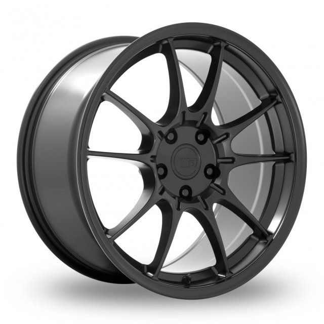

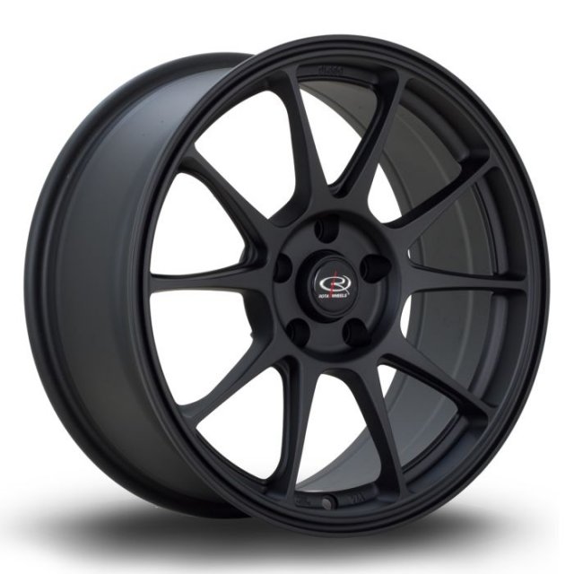

Hey, need a little help with my choices. Been from pillar to post, US to UK to try and find what i'm looking for and landed on these three which are the final contenders.
Rota Titan 17x7.5 4x108 et40
Rota SS10 17x8 4x108 et42
Motegi MR152 17x8 4x108 et40
Wondering what would fit the most flush or generally what is consider to be the better fitment. They all look great IMO so it's really down to what works the best. I know theres a very minimal difference. The 17x7.5 et40 i know will sit slightly more inside the arch than the 17x8 et42 and the Motegi i think will fit the flushest i just want to make sure i'm in the right ball park. Any advice is welcome. Thanks.

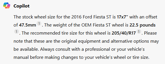

Thought the stock wheel was 7.5 but this says 7.
<<The stock wheel size for the 2016 Ford Fiesta ST is **17x7"** with an offset of **47.5mm**². The weight of the OEM Fiesta ST wheel is **22.5 pounds**². The recommended tire size for this wheel is **205/40/R17**². Please note that these are the original equipment and alternative options may be available. Always consult with a professional or your vehicle's manual before making changes to your vehicle's wheel or tire size.
Source: Conversation with Bing, 5/12/2024
(1) Fiesta ST Wheel Size, Bolt Pattern, Offset & Tire Information. https://www.fiestastforum.com/threa...ze-bolt-pattern-offset-tire-information.1126/.
(2) 2016 Ford Fiesta - Wheel & Tire Sizes, PCD, Offset and Rims specs. https://www.wheel-size.com/size/ford/fiesta/2016/.
(3) 2016 Ford Fiesta tire and wheel sizes - TireWheelGuide.com. https://tirewheelguide.com/sizes/ford/fiesta/2016/.
(4) en.wikipedia.org. https://en.wikipedia.org/wiki/Ford_Fiesta.>>

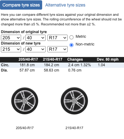

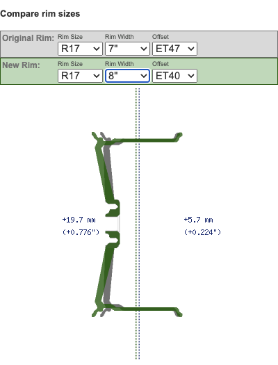

Leaning towards the Titan with maybe a safer 7.5 width. On this wheel size calculator you can see the 7.5 is basically right where the back of the stock wheel would be but on the 8 wide, is that enough to cause rub? I'd probably look to go 215/40/R17 for the tire too as stock is 205/40/R17.

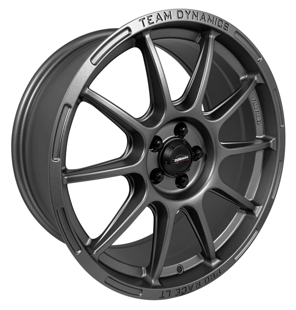

This one could also be a consideration, Team Dynamics Pro Race LT. 16x7 or 17x7 4x108 et38. Hard to decide between renown quality and strength or something that may be slight less quality but probably perfectly fine for everyday driving.

7,271
The new TD Pro Race LTs ARE now flow formed (and therefore both lighter AND stronger than the original cast, albeit yes heat treated, Pro Race 1.2s), and fully approved by all of the major safety testing orgs (JWL,VIA, and the TUV), so if your B roads are that bad in surface conditions, it is a brilliant idea.
I don't know how their pricing is on the other side of the pond, but they are somewhere in the vicinity of ~$125.00 per wheel (depending on size/width chosen) more than the Titans are here, currently.
Definitely feel like this is a good bet to go with the DT Po Race LTs over the Titans, i think they'll hold up a lot better on these roads. $125 per wheel is a great price as i've found them here for £210 per wheel unless anyone has a better UK source for these? Still thinking the 16x7 4x108 et38 with a thicker tire, or would you stick with the 17x7?

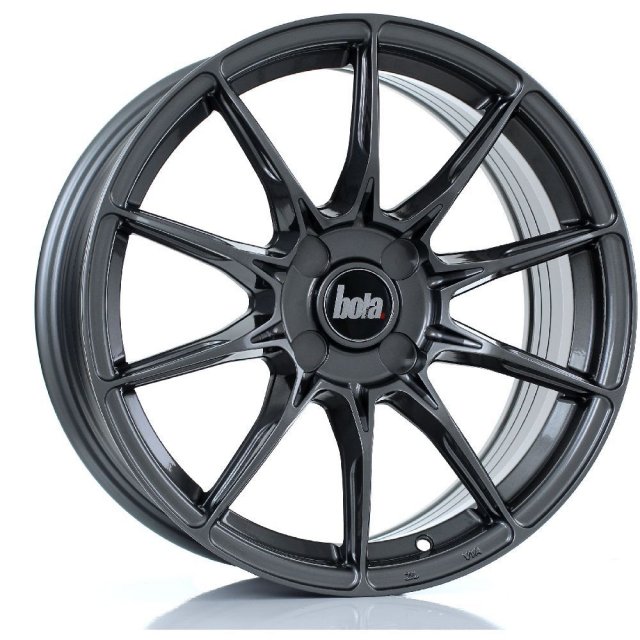

Ok, think i've settled on these after all that. Bola FLB 17x7.5 et40 or et38 if i can get away without rubbing? Ganna go with a 215 tire if possible, think stock is 205.
I'm not familiar with those wheels, but they look good. The stock tire size is 205.
What's the weight on the wheels? The stock wheels weigh a fairly hefty 22.5 lb, if you can save at least a couple pounds per wheel of unsprung weight, that has nice benefits. It makes the car ride a little bit smoother, less weight bouncing up and down, and makes it feel a little lighter on its feet.
Good luck, let us know how you like them after you get them.

Thanks Capri i'll let you know. I think these come in at 7.6kg at 17x7.5 which i think converts to about 16.7lb so a huge saving on weight. I think the TD Pro Race LT at 17x7 come in at 7.9kg but could be wrong.

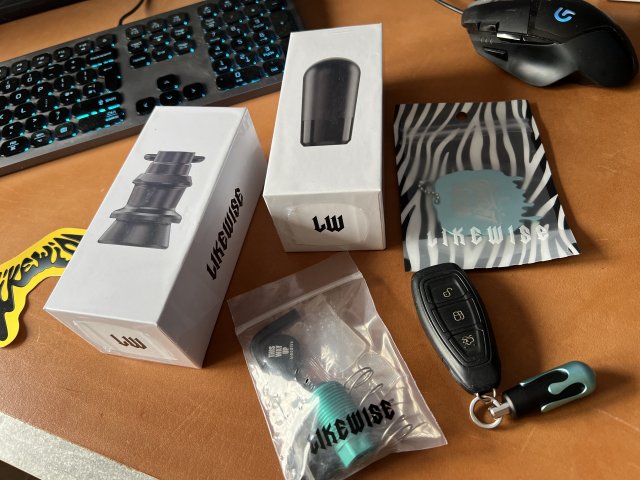

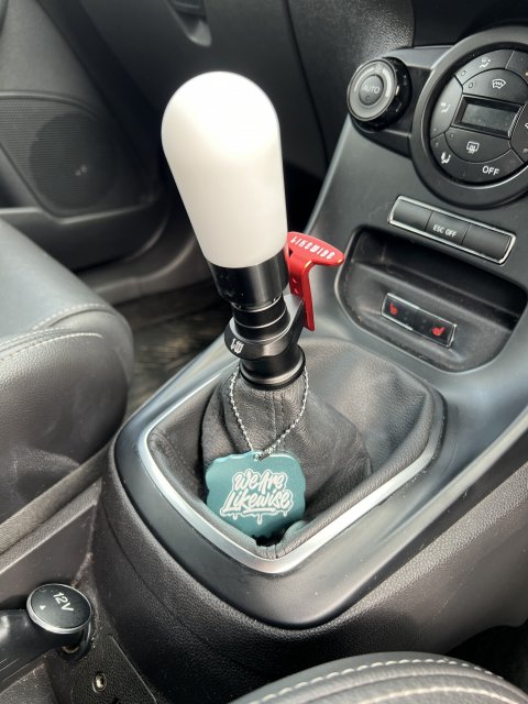

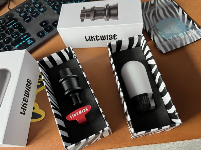

On a different note, wanna give a shout out to these guys in Australia. Likewise are by far the best for custom gear shifters. The look and feel is high quality i just fitted mine yesterday. https://wearelikewise.com/
That is an excellent saving of weight, they are even a little lighter than my TD Pro Race 1.2's, which are 17.2 lb in my 17x7 size.
Those look similar to the Speedline Corse Marmoras (at least the spoke curve/bend/shape/how the spoke meets the rim, does) which is another brand we are not allowed to have on this side of the pond, along with those Bolas. [:(]
At this point, I will ONLY install a 215/40-17 tire (the widest tread width one I can find which is 'streetable' in tread wear/tread pattern) on any 17" wheel on this car, as it sits (with no fender; pulling, rolling, cutting, re-configuring, or flaring). [thumb]
Really like that pull tab lever for the reverse lockout ring!! [twothumb]
If I ever get tired of my Ford Racing carbon look deal, I will contact them! [driving]
