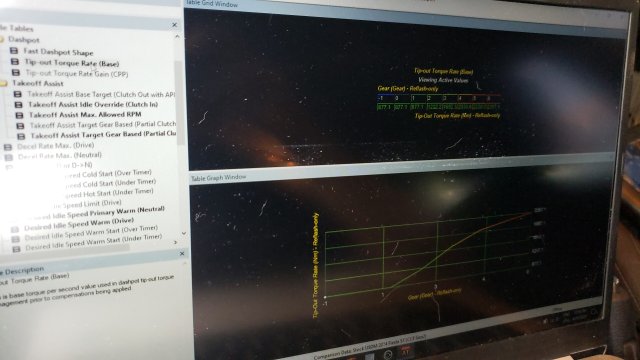

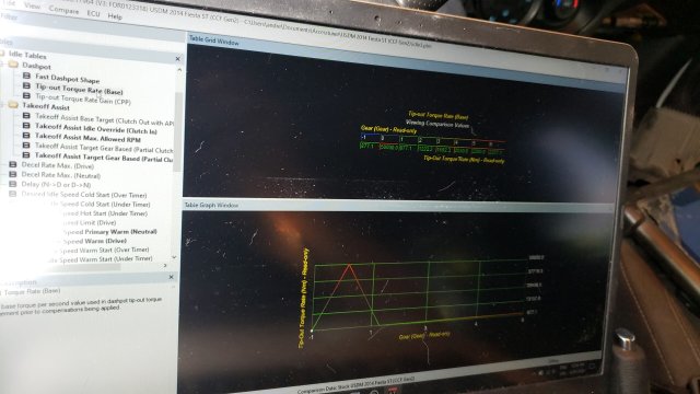

Fixed the idle issue changing the dashpot tables on neutral, the high values are from the stock maps, if someone has that problem feel free to copy the table values

I know, but checked everything and the problem only occurred when dashpot was active, when it didnt reach it there were no issues...
