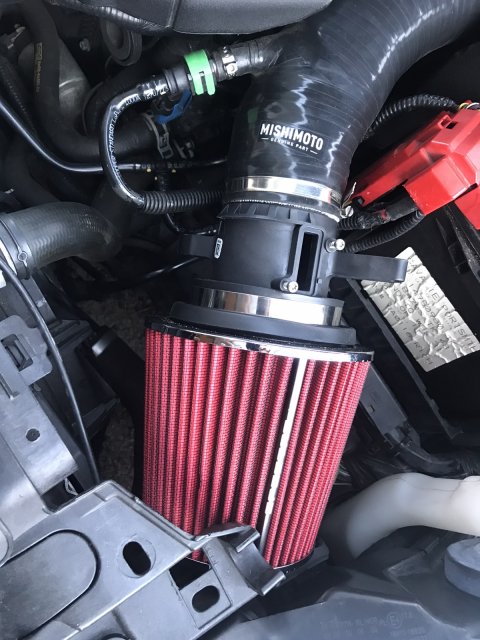

After going crazy looking at filter dimensions I settled on this one http://www.knfilters.com/mobile/mProduct.aspx?prod=RU-4450
Looks to be a little smaller than the one in the original post. Hope that will avoid the rubbing on the hood prop clip.
Now just waiting for everything to show up!
Should have a mtc intake hose coming too.
Anyone have issues with water splashing up? Debating if I need a filter cover or maybe the metal shield linked earlier in the thread.

Got the maf adapter in the mail today. 5 minutes to swap over. If it's terrible and temps soar it's only 5 minutes to swap back.
Feels like it needs a bracket or at least a zip tie to keep it in place.

So I wanted to make something cheap for use in winter time and thought it would be easy to find that MAF adapter. I was wrong. Chinese eBay has some but not sure if the maf location/orientation works.
Being in Ford parts I discovered an inexpensive part used on early NA mk3 focus’. Was only $7 my cost number BV6Z-9B642-A and I used the cheap universal Spectre Autozone filter. Still need to fab up something to secure it (for now I’ll zip tie it thru the ears on the adapter to the stock airbox mounts.
