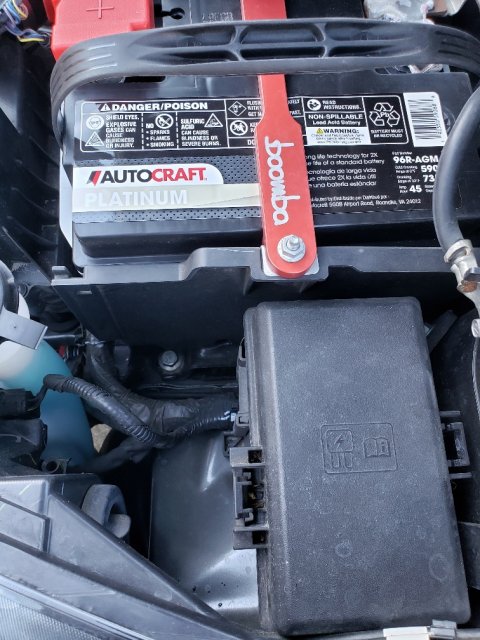

Ok new battery, new starter as of last weekend. Cleaned terminals and grounds. Car still decides when it wants to start first push of the button. This is gonna be annoying as shit. Now i gotta dig deeper. Im gonna replace the clutch switch, and the start button. Guess i should replace every relay and fuse relating to the starting system. Idk whats up but its aggravating
