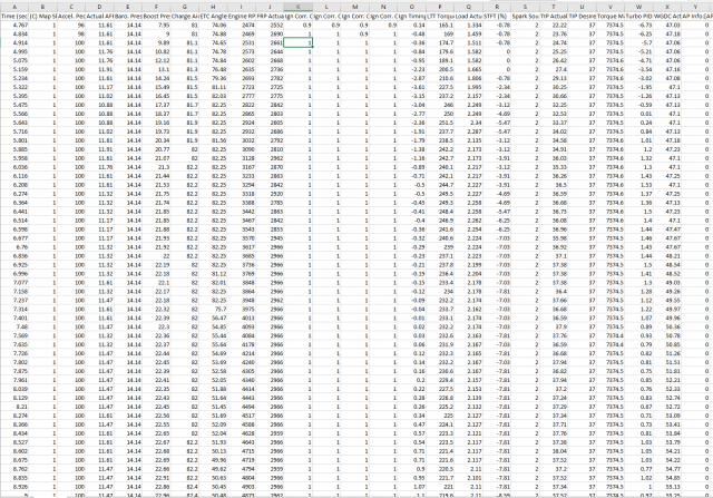

Hey All,
I was looking at my most recent data log and was curious to know if ignition correction (degrees) is what limits the power output of the tune? I can see my ignition correction is always 1. So to me it seems that this will dictate how much timing will be limited on the Tune.
What is everyone else seeing for their ignition corrections?
***Update - The reason I'm asking is because my car is running lower power numbers than a lot of folks with the Whoosh Hybrid Turbo and I'm trying to find out why. I think it's because I told the tuner I wanted a SAFE tune. So if that's why the power is lower I'm totally ok. But if it's not I need to find out what the car is missing for more power. Car is on 91.
Here's the data below:

Now I'm not a tuner so I may be talking out of my ass, but I would think the main contributor for limiting power would be knock. Whether that be bad fuel or needing colder spark plugs or whatever else.

you look like your Boost limited. That log looks like you are running a stock turbo with Tune levels on Boost and ya you are getting some ignition corrections. Which will pull timing, which will limit power.
What revision are you on. I was pushing 27-29lbs of boost by my second revision. Even my first tuner had me at 26lbs of boost .
I would say you should be pushing at least 25lbs but the highest boost I saw in that log was 23lbs.

Yes I hardly ever get higher than 23 and only for a moment but it's mostly 22. I think that the 11PSI TS wategate might be a bottleneck. But if knock exists then maybe even upgrading the actuator wont help.
That was the Tune I got sent to test the new Whoosh Short Ram Intake and the new AIRTEC Enlarged inlet. Adam turned the boost down 1-2 PSI he said to see how it reacts and will crank it back up. But I cant recall ever seeing higher than 23 PSI even before all this.
I'm hoping for some gains with these 2 parts I added. I sent him the log and am waiting for another revision.

No. his ignition corrections are positive. So it is adding timing. This is not pulling timing (those are negative corrections)

Knock is what limits your cars peak power. You should log knock counts in the cylinders as well. Not really for monitor on the AP but its valuable on WOT logs
A high power tune is one that will continuiously bump timing up to the knock threshold. It will then dial timing back to a level just under where knock is occurring. This is where the theoretical peak power of the car is.
If you told the tuner to do a conservative tune, he just wont set the ceiling of the ignition timing to as high as he could. This should in theory keep the car out of the knock area
Ignition corrections is essentially how much the car is continuously adding timing, up until a ceiling. This is tuner set. +1 is pretty conservative. What revision are you on? Maybe your tuner is just feeling the car out before really bumping up timing. Ideally you'll do a log where you just tap into the knock space and then you'll back off on your ign tables a bit from that

I believe I had 5 revisions when the car was originally tuned.
Since then I've added the Whoosh intake and the AIRTEC inlet. So I ordered a new tune.
This data log came from loading the new tune with the boost dialed back a hair to see how the motor acts with the new parts. The tuner said he's going to bump up the boost again on the next revision.

Knock is what limits power on a tune.
The tuner can adjust how much timing is added (max), and how much can be pulled. We can also adjust the speed/intensity of how they are applied and when to start applying.
It all depends on how the tuner constructs their timing maps and strategy.
