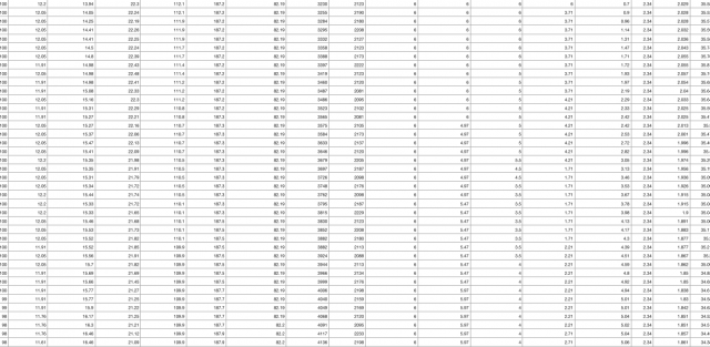

Hey everyone,
I am attempting some data logging with the 2018 Mountune RR1 91 beta 2B preloaded map from the FB3 package off Mountunes website for revisions with Randy. I noticed at 2300 in rpm, the ignition corrections for cylinder #4 drop 2 degrees to +.07 from +3.2, every other cylinder stays at +3.4 degrees. Is this a bad sign? Is cylinder 4 going too be an issue or is this simply something the tuner will compensate for in the new tune? I plan on being in slot 4 aka panic mode too avoid more/any detonation. I have been using QT brand 91 octane fuel and have OAR values of -1 on this map. Car har 8200 miles on it with basic Mountune stage 2 bolt ons;
Mountune High Flow Induction Hose, Mountune High Flow Lower Intercooler Charge Pipe, Mountune FB3 Package(intercooler, RMM, Cobb APV3, airbox[still have not recieved]), Mountune Turbosmart Kompact BOV kit, & Radium Engineering Dual Catch can System​
Here is one of the data logs showing this; I hope someone can put my mind at ease or at least give me a sense of what I should do moving forward. I've been doing my best to learn about ignition corrections and OARs, if there are any other things anyone thinks are worth expanding my knowledge on please let me know. Im really trying to be a student of these motors/cars. Ive been data logging with Randy at mountune however I have been experiencing difficulties with the actual data or following the exact instructions and keep having too redo logs and that takes around 7 days to hear anything back. Any help or if someone can glance over my logs sooner and give their thoughts I would really appreciate it, thank you Fiesta fam.

I am kinda in the same spot as you regarding custom tuning with Randy. Negative corrections is a rabbit hole of a topic, but from what I have gathered, some neg correctly isn’t a bad thing as long as it’s not frequent and severe (more than 1.5 deg or so). I plan to just keep the back and forth going with Randy until we settle on a safe reliable tune.

Thanks for your input, it is definitely a rabbit hole topic and I can't really ever get a solid answer. Kinda makes me think it may not be a big problem unless your driving it too redline everywhere you go. I try not to go over 4500 rpm really so hopefully granny shifting will be on my side. I hear your supposed to drive these motors kinda hard.. however that is difficult to conscientiously do when I see contestant drops in correction on the same cylinder (#4). What are your (& anyone else that would care to share) OARs may I ask? On a stage 0 tune I can't seem to get any lower than -.61 and on the stage 2 I am able too achieve -1 values. The instructions seem to make more and more sense every time I do more research or read an article on eco boost motors, I've been having lots of aha moments rereading the instructions or previous emails and data logs. Also I've been looking back at my previous logs from weeks before and it looks like cylinder 4 was getting less positive corrections than cylinder 1,2, & 3 (ie. +6, +6, +6, +4.5 degrees of ign. corr.) on the stage 2 map. Should I be concerned or is this normal to have these inconsistencies across the cylinders. Does anyone have any idea as to how many knocks counted are bad? I understand these motors do knock and that it may not be a bad thing but is there a number, say for example if I hit 5 counted knocks on cylinder #4 in one pull or something like that. Ive only seen up too 2 counted knocks in cylinder 4 on a pull so I'm not sure if thats okay, I'm curious if theres such a thing as too many knocks. Thanks for any input from anyone it is greatly appreciated. Have an awesome day

Well it seems to happen around 4k at WOT and corrects as I go up in the rpms, I don't really want to take it too high though. Ill post a fresh data log later with some analysis or something. They aren't ever in the neg numbers, they aren't as high of corrections as the other cylinders. ie 1,2,&3 will be at like 5 or 6 and it might be fluctuating from about 2.75ish up to like 5.8. Once again they don't go negative they aren't as high as the other cylinders and it does tend to fluctuate up too 3 degrees. Ive read somewhere that even if they aren't going negative and are adjusting up to 3 degrees like that, I may have an issue. Im running the panic mode and will post a data log from today to show the numbers. It is a struggle to find some E85 in Tucson but I will try. In the meantime I have been looking at flash tunes from companies like stratified, cpe, and mountune.. is a pro tune any different? Im still in my 45 day data logging period with Randy at mountune and am waiting for a response from the data logs I last sent. Ill have to check out #4s plug and see if replacing makes a difference. As far as oil I am already using an oil made for GDIT and eco boost, been running Castrol Edge 5W20 for the last 3 oil changes. If you have a better suggestion other than royal purple ($$$) I'm all ears, I figured that was good enough since it says specialized for GDI Turbo engines on the bottle(mentions eco boost on the back as well). I like to replace the oil based on color and miles and would rather not spend like $40 on purple oil. Im up to anything that is known to be better in the community though.

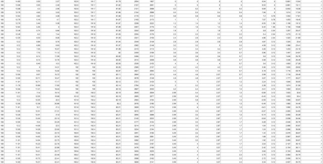

Screen Shot 2019-06-11 at 7.48.31 PM.png It looks like right at 3200 rpm cylinder 4 goes from +6 to +3.71, back up to +4.21 briefly and then continues to drop to +1.71 at 3700 rpm. It does raise back up too +2.21 around 4k and at 4200 i let off slightly to 96% throttle and it roes up to +3.21 again before I let off throttle. Im hesitant to go higher in the range, also worth noting that I currently using the "panic mode" slot of the mountune beta map. Also my OARs are at -1, it wouldn't fit on my screen shot. Any input would be sweet! Thank you

Update on the corrections... Randy sent me a revised tune 3 days ago and things are much better. I am not seeing the inconsistansies on timing corrections like I was seeing before. I have been using the full boost slot one and am seeing est torque numbers of 265+ at WOT (what my APV3 is estimating). However I only see these numbers when it is cooler outside; ATM Tucson AZ is seeing 100+ temperatures during the day and even with the upgraded intercooler and a/c off I don't see boost higher than 21-22 psi and est torque figures around 250. I don't ever push the car in these conditions but I've been curious to see how the heat affects the numbers my AP will put out. Id really like to get an upgraded rad/oil cooler to keep my temps down and be able to report some numbers for the summer. Also I installed a CPE Blockd DV Delete Plate to cover the factory diverter valve location on the stock KP39 turbo, I am now seeing much more consistent boost levels through out the rev range. This is probably a combo of the elevation adjustments and data log revisions Randy made too the
Mountune map plus the delete of any boost leaks on the turbo itself. I will post more recent data logs soon if anyone is interested in checking them out.
