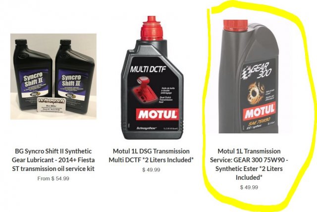

Guys,
I see on Whoosh website he has 3 options. I have a 2019 only has 3K miles on it but thinking while I have access to a lift I would change the fluid just in case I only had 1.6 liter fill and not the 2 liter fill. It is cheap enough and figure it can't hurt and from reading on here those that changed their fluid said it shifted better? I don't have any shifting issues but I don't want any issues if Ford didn't put in the right amount so the one in yellow is that the way to go.

I am and I love it

I just used the standard Motorcraft DCT Fluid. Same great shift quality that I had before with the peace of mind from changing it.

I tried the motul 300 and didn't like it. It felt particularly bad when temps drop.
I changed to the motorcraft dct fluid and got the same excellent shifting I experienced with the factory fill. If I change it again, I might try out the triax synth dct as it seems less expensive and meets the spec requirement.

I have the Triax fluid and it's great! Meets all Ford specifications and is less $ than all the others.

i do not like the Motul 300. It shifted better with the OEM fluid. Im going to go either BG or Ravenol next time.

Ravenol. Smooth, full synthetic, and meets Ford specs.
My tranny was working fine when I changed it, and I still noticed a difference.
