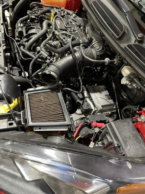

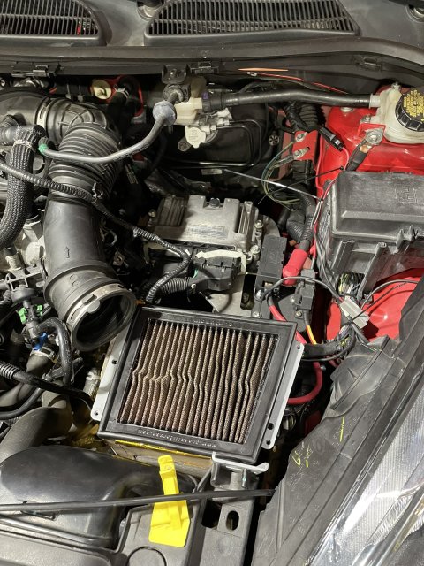

Debating what to do about my air box. I am debating building a full sized airbox that covers from the mater cylinder to the shock tower to the end of the engine. It can be open and seal against the hood and cowl. Then I could run an open cone type filter with a proper velocity stack. Not sure if I want to just use a transition coupler to the OEM intake tube or build a new intake tube to the turbo inlet. Not sure where the restriction really is from a turbo and power stand point.

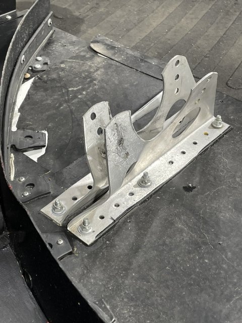

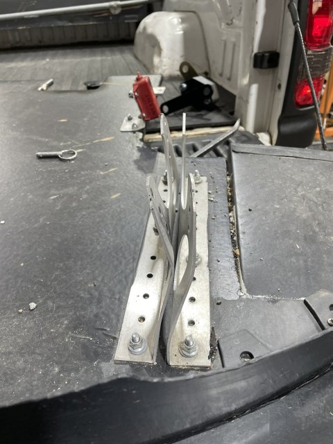

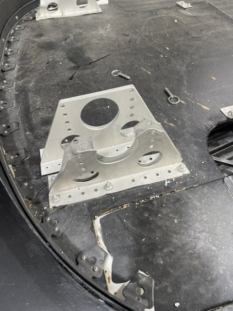

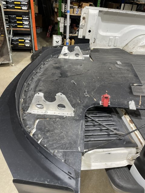

Don't let your wifey daily the car with the splitter. I also forgot to attach the wire for the transponder and it got ripped off somewhere on the road. I hope I can solder something back to that little stub and fix the wires. This sucks.
