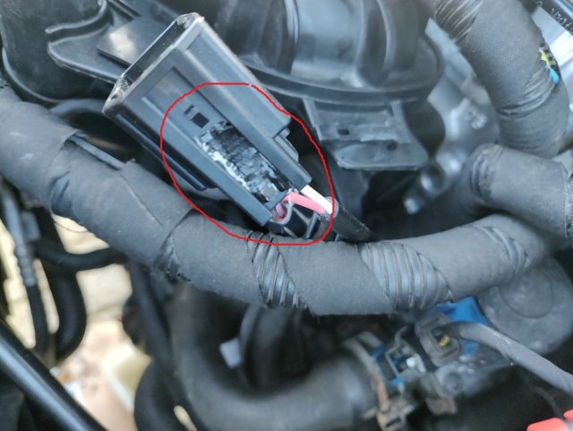

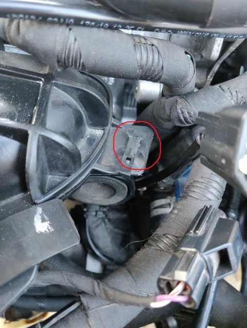

Hey daloonie, do you have a picture of when you had this issue by chance? I have the harness pulled out a bit where I can see the crank sensor and I could take a look tomorrow.
Sure do, this little tab broke, and it's what holds the connector together. Fixed it with duct tape to make it friction fit and sorted the whole issue.
Sorry for the late post, been far far away from my Fiesta due to the second engine failure.
