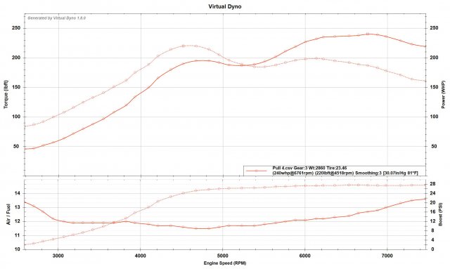

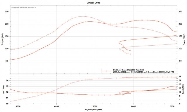

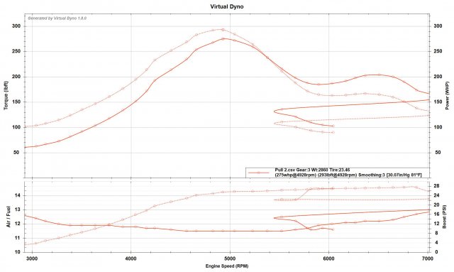

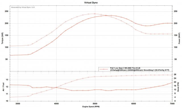

Just to say, the car feels faster than these numbers. Kind of surprised me they are so low.
Se7eN
#2001
904
786
Are you logging just one gear? not letting it hit the limiter or going WOT on another gear? Vdyno does not like that
