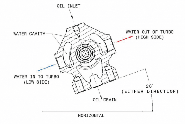

I'm starting to pre stage things for the motor getting here thursday. The x57 has 2 lines that come with it. After much confusion I think these lines replace the hard lines the fiesta came with... Am I right or wrong. The only part I'm very confused about is that one line goes front one goes back so it's not the same as the fiesta came with. There's also an extra bolt hole.

The in and out should have an angle in relation to each other, the water-in port on the lower side and water-out on higher.
