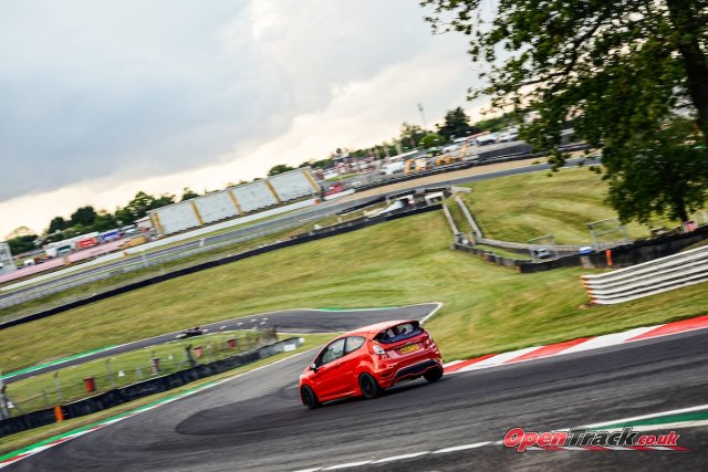

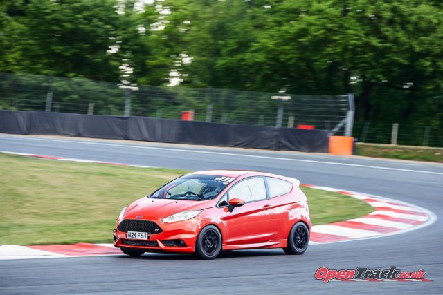

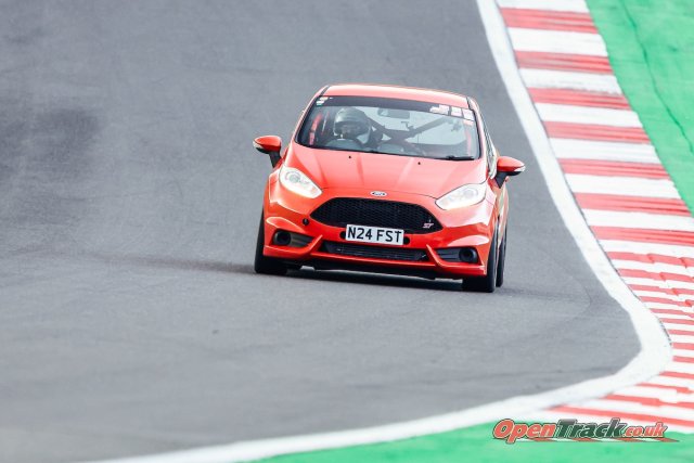

Had an evening track day last night at Brands Hatch. The weather was forecast to be awful and I almost took the MX5 but wanted a shakedown in the Fiesta before the Ring trip next week. The weather turned out to be glorious and the track was pretty much empty all evening! Did around 100 laps total and the car for the most part felt absolutely amazing. I added a Whiteline a few weeks back which has really helped with the rotation. The only exception was the brakes - after about 20 minutes the pedal feel was awful. I knew downsizing from the BBK would be noticeable but I can't even get through one track day without needing to change the fluid! Best time of the day was a 54.9 which is 2 seconds faster than last time I was here with the 17"s and the Avon ZZR.
I'm using Motul RBF 660 which should be fine, but may need to consider stepping up to something else. I've also ordered the 302mm front disc upgrade from Pumaspeed, hoping this will add enough extra mass to keep the fluid temps down.
