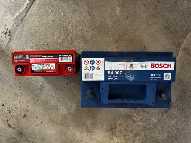

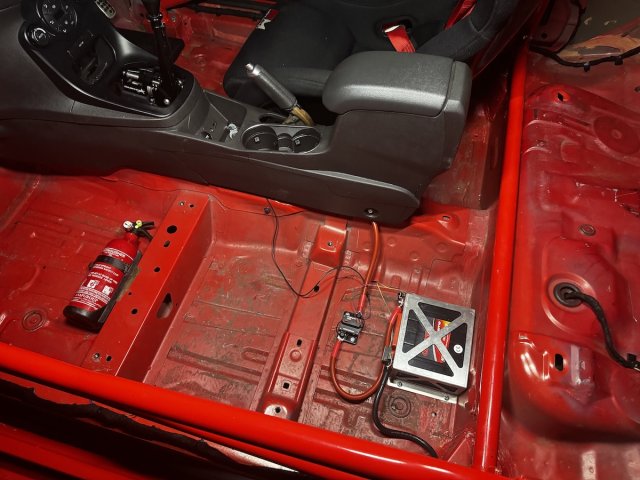

First up I picked up an Odyssey PC680 and relocated the battery into the cabin. It's used 35mm2 cable with a 300a circuit breaker next to the battery so I can kill the car when it's not in use.

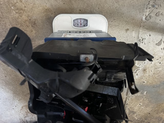

The old battery and a bunch of brackets/fixings came in at 20kg. The new battery is 6.8kg so a pretty big saving.
It still needs some tidying up but is working perfectly so far. The only thing I'll be changing before the track day is to replace the distribution block in the engine bay with one that can be fixed flat. At the moment it's cable tied out the way which is not ideal.

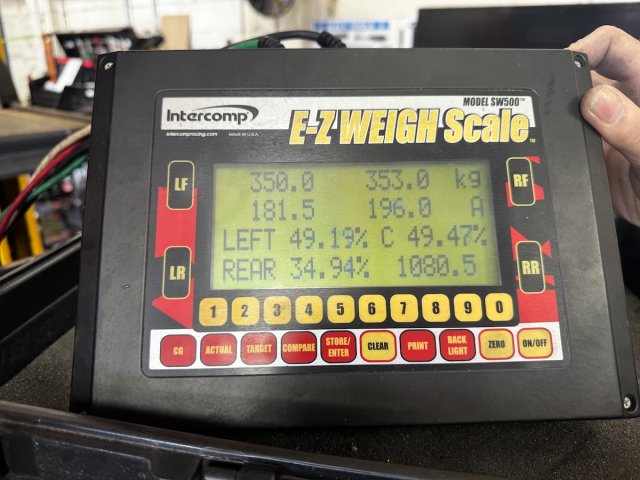

Next up was corner weighting. Without me in the car it came in at 1080kg which I'm super happy with!

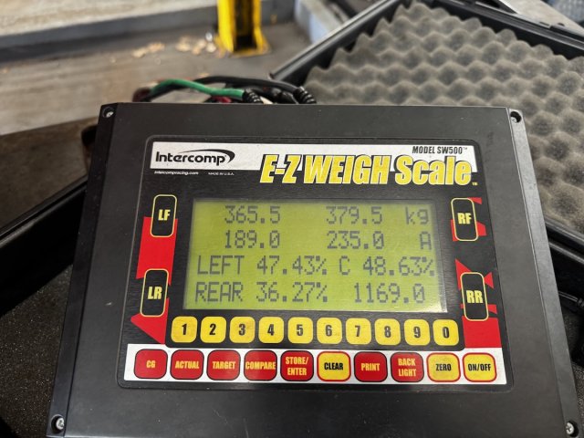

And after some adjustments with me in the car and half a tank of fuel it's 1169kg. I think this is pretty much the cars final form unless I decide to add aero or change body panels which I'm not super keen on.
