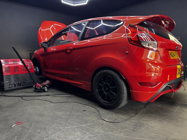

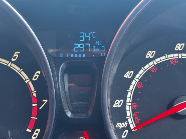

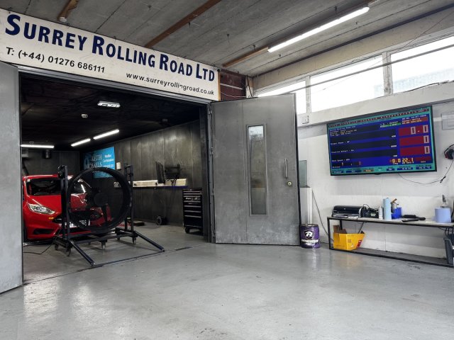

Few updates since the engine swap - firstly I took the car to TRS to have it mapped for the S280. It was one of the hottest days I've ever experienced in the UK at 34c (93f), I know this probably sounds weak compared to the US but the guys working on the car were dripping!
I asked for a few changes compared to the way the car was set up last time with the X47. Most importantly I wanted lower boost (to keep temperatures lower) and for it to come on more progressively so that it didn't light up both front tyres on corner exit and kill driveshafts. We had some issues with the dyno on the day and the clutch kept slipping which not expected. In the end they road tuned it and everything was fine so suspect it was the dyno itself. Took it to Surrey Rolling Road the following week and had no issues, and made 280hp which is right about where I wanted it to be.

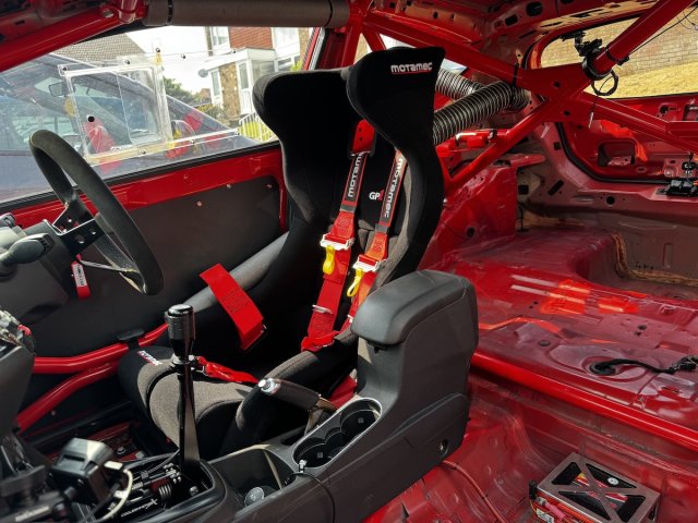

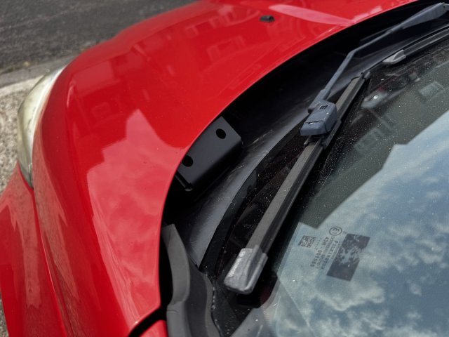

Continuing the work for Time Attack next year, I installed an FIA approved seat and an FIA approved 6 point harness for HANS. I'll keep the old seat for when I go back to the Nurburgring as there's no way they'll allow it for TF.
I also installed a pull cable bracket from SW Motorsport for me to mount the fire extinguisher and cut off switches when I fit them:
