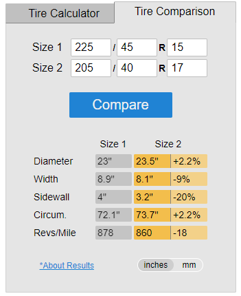

I really don't think that the gearing issue is as big as a lot of people think- there isn't nearly as much difference as you would see if you were in a truck going on to huge mud bogger tires.
edit- added the resulting speedo error, which would be hard to even see on course
I certainly notice it on track. I ran a 205/50R15 for a while and now run a 215/45R16 and it was very noticeable as far as gearing through corners. The taller gearing helps with wheelspin(even with an LSD) and holding a specific gear through a corner. Holding 3rd versus shifting into 4th or holding 2nd versus shifting into 3rd....etc. That can make a fair difference when on track in a competition setting. For daily driving it doesnt really matter to me where the car sits RPM wise as long as it isnt 3500+.
Huh- I certainly noticed the difference in grip 225 vs 205, but haven't noticed a gearing difference. I haven't had the opportunity to try them out side by side, though.
