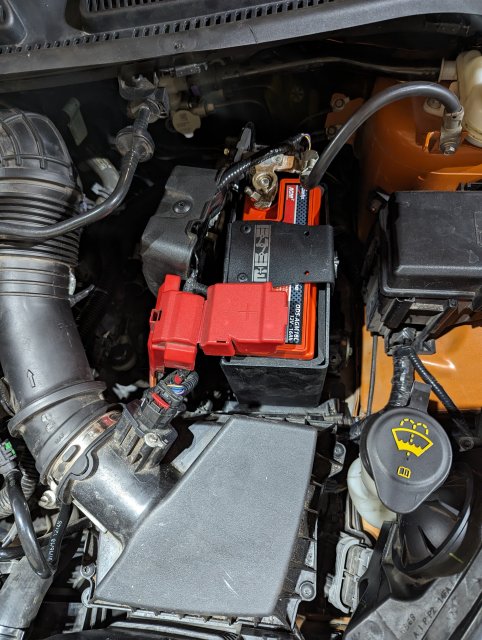

The battery in my 2018 that i just bought is original, and I can tell it is dying (6 years old). After doing too much reading, going back and forth between AGM/lithium, and taking cost into account, I decided on a 15lb Deka battery, ETX20L. Apparently they make this battery for most auto parts stores, including braille, napa (napa legend premium agm) and autozone (duralast gold agm), and probably the oreilly battery also. It is 310CCA, 17.5Ah @ C/10 discharge rate, and weighs 15lbs, much lighter than the stock 31lb brick. The cost was $120, which is much less than the 5lb shorai LFX36L3-BS12 and costs $325 ish. I will monitor the voltage and performance of the Deka, hopefully it will last at least 4 years. I am in San Diego and don't plan on driving to a sub zero place any time soon, but I should invest in some good jumper cables just in case lol.
The other things I'm curious about is what is the draw on the battery in full shutdown mode, and can I install an automatic disconnect to remove the battery from the circuit once voltage reaches something like 12.2V. I have some experience with BMW Intelligent Battery System, and ford's is very similar (I assume all new cars have a IBS of some kind now). I still need to get forscan and code in the new battery specs, just like I had to do with my e90 330i when installing a new battery.

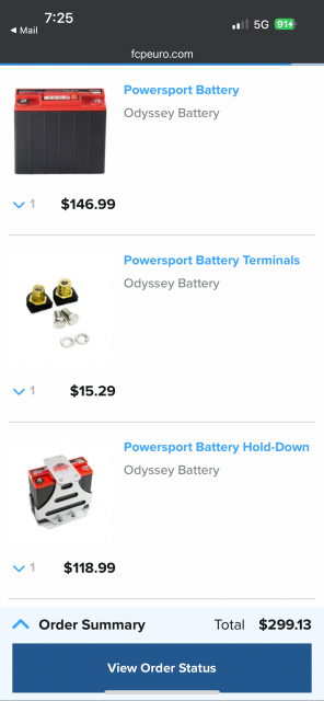

I was in the market for a new lighter weight battery as well. I decided to pull the trigger on the Odyssey PC680. Ordered it from FCPEuro.com. Price is reasonable and they offer a nice battery box to go with it. Total of Battery with box and terminals $299.13 shipped. I feel thats very fair.

also you get the benefit of the amazing warranty program fcpeuro offers

Wow that's a great deal! I didn't even think of checking FCP... have bought things there before, great company! Good luck with install, let us know how it goes.

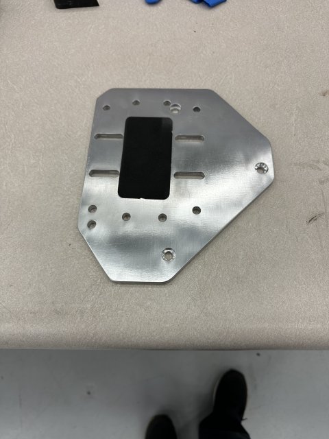

Thanks I definitely will. Worse case scenario ill end up having to make an adapter plate for the new battery mount to mount to the stock mounting bolts. That should be easy peasy considering I have the old battery box so i can get the location of those holes from that. Maybe ill make a few extras just incase others go the same route. Ill keep you posted.😎

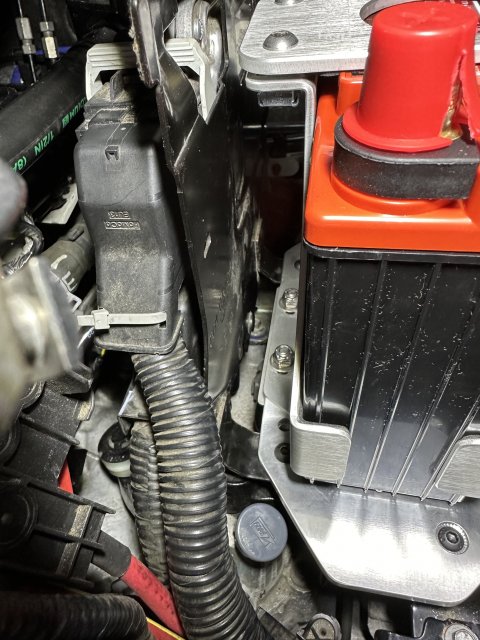

I just bought the Mele Design battery box, and I'm having trouble mounting it. The holes in the lower mounting plate do not line up with the holes in the bottom of the battery box, and the wiring harness for the ECM won't let it get anywhere near where it's supposed to mount to the new battery box. Any suggestions before I send this back?

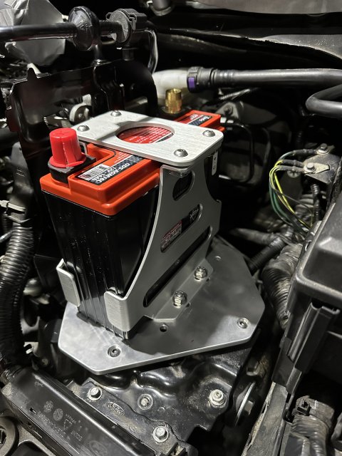

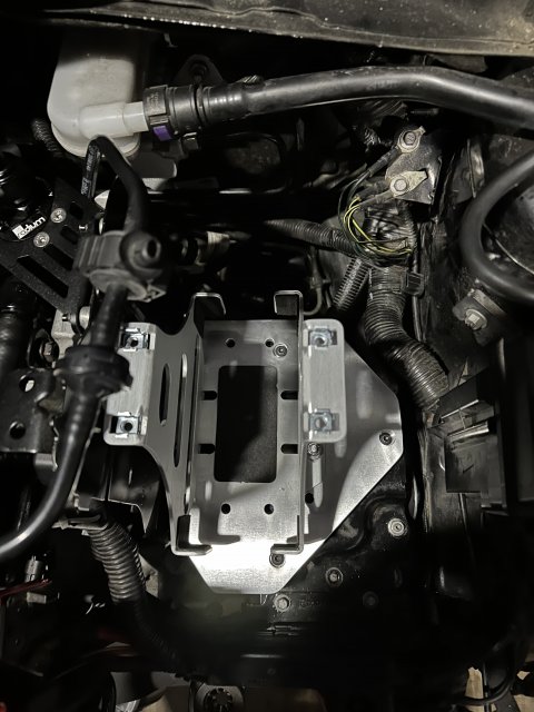

You can do what i did and make a mounting plate that mounts to the factory locations and will work with that aftermarket battery box. Also ecu bolts to the left underside of this plate.
