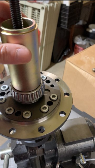

I don't see why you couldn't just stack your shims, its effectively the same as buying the correct size one. They will be held in place by the bearing race anyway.
The Ford Performance way might not be the "correct" way, but I haven't seen a failure here or elsewhere from following those procedures. This may be different with a clutch type LSD that relies on pressure to make it work vs a mechanical LSD. Not every DIY'er has access to the tools to do it and a lot of transmission shops won't even touch our transmissions due to the lack of availability of individual parts.
If you don't mess with the shims you don't have to touch the bearing race correct?
Correct. Can literally just open the transmission, take the old Diff out and drop the new one in (after you press new bearings on it)
Thank you. The companies selling these differentials should offer a service to press on the bearings for you.
Hammer them on with a large socket... lol. They likely do not offer the service because you risk damaging the bearing in shipping, not to mention if you wanted to swap out the bearings for metal cage variants... etc.

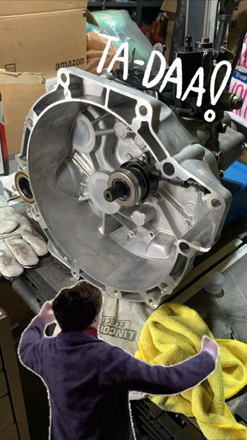

So transmission is in. Bleeding the clutch was stupid. The manual say pump IN 80 ml of fluid. That did not work. I sucked OUT air and 80ml and the clutch worked. Cruises around the block a few times and all is well. Clutch was soft and brakes were too. Parked it up and bled out more air from the brakes and clutch.
TLDR: Try to cap your clutch line off when the transmission is out of the car. It was the only open line, and it took a lot to get all the air out.
