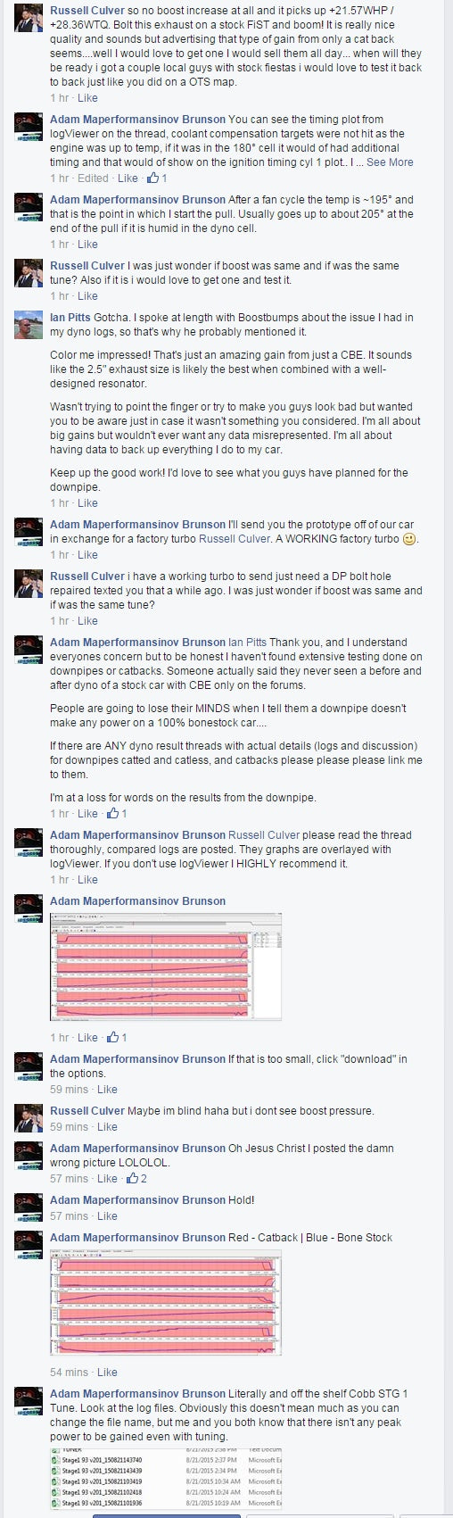

Here is the conversation between a few of us on facebook as well if anybody would like to read it. Covers a few more details.
maperformance
maperformance
701
258
Cottage Grove
Thread Starter #64
As you can see in the conversation above, I requested links to other downpipe/catback testing. Not together, individually.

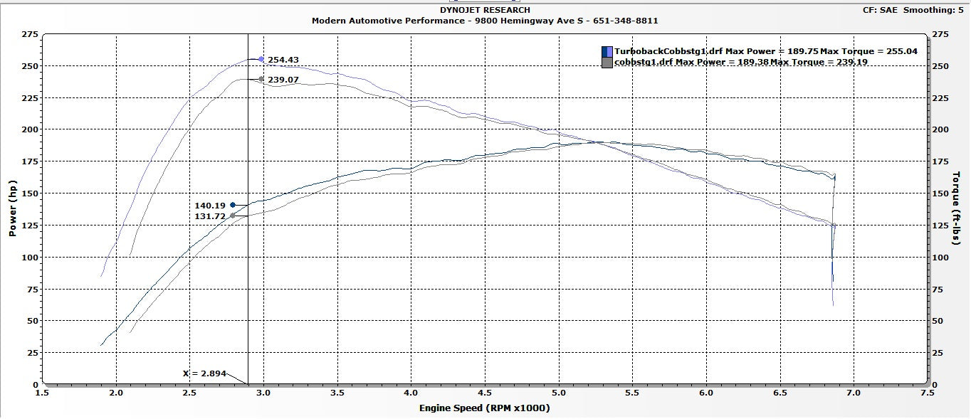

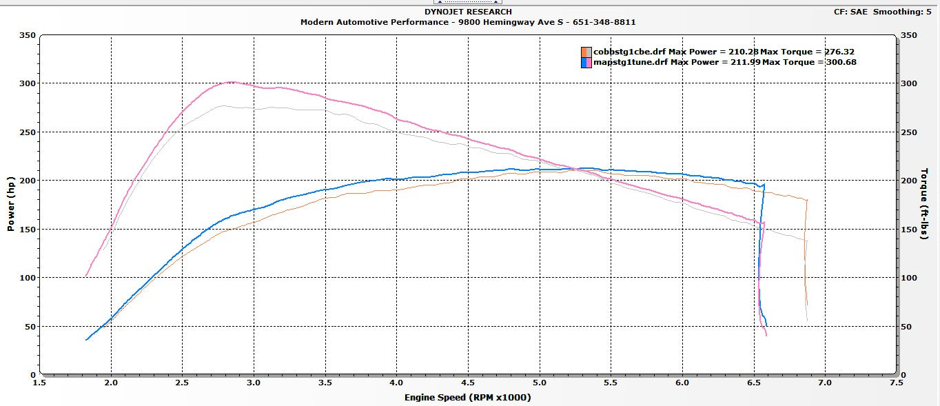

Just so we are all on the same page, when I say there is no power gain there is no PEAK power gain. There is definitely power to be had through the powerband, I should of stated that and that is my fault.
I kept the tune file the same for the testing, but for my own testing I threw on my custom tune as I mentioned in a previous post and the gains were minimal within 1-2hp of each other.
Here is a bone stock car on a Cobb Stage 1 OTS tune, compared to our catless Turboback with Cobb Stage 1 OTS Tune.
As you can see the peak gains are not there on the HP side but was up about 15wtq. The car just likes the stock downpipe when it comes to peak performance.
I'll provide any data that you all would like, but you have to understand that I would of loved the downpipe to make more power so I can sell them and bring you top quality products. However I am having a hard time offering a product that will reduce the power output for 90% of the Fiesta ST's out there because they are on stock turbo.

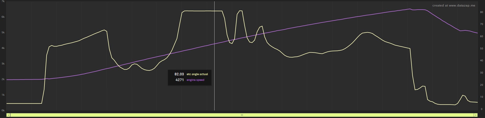

If anybody isn't following our R&D thread, here is a log post that I put up:

Wait, why are these even being tested on a Cobb Stage 1 tune? Was it arbitrarily picked? Why not test each part, independently on the vehicle with it's stock tune? Next, in combinations? Afterwards, test each part again on each staged tune, in the same manner, if you wish. Then, with your own tuning strategy do it again. Hell, you could test the hardware with the software, and turn around and test the software with the hardware... So, the question remains, why is testing even happening on the Cobb Stage 1 tune? If that's been succinctly answered, my apologies.
Because the factory tune has a lot of load control ceilings in place. Here is a log from the factory tune, you can see a ton of throttle closures to keep load at a minimum to increase efficiency as that is the cars main purpose, power is secondary. My marker on the image below is the only point that the throttle body angle is at 100% (~82? OA).
If you were to use the stock tune it would keep limiting the vehicle from making anymore power, it would increase torque slightly but I mean SLIGHTLY.
If you compare parts on the stock tune then everything is limited and your overall numbers will be restricted by the tune. The stage 1 raises limits so that parts can produce whatever they can produce, comparatively. Stages 2 and 3 simply take advantage of increased boost and timing, mostly, so introducing them into testing would add an unfair advantage and additional variables.
Basically, by running everything on stage 1 you can make an accurate assessment of whether a part shows an improvement because without that change the stock tune will limit it. It keeps the tune 'playing field' level for part increases. One of the issues I've had with other companies' testing is that they would test a car stock and then show their 'gains' using their part and a tune (or starting with stage 1 and parts and then adding a part dyno'ed with the stage 2 tune, etc).
Tl;dr-Any part needs stage 1 to show gains that would otherwise be limited by the stock tune. Additional tuning can be done beyond that to extract additional power from the setup, but that would be power extracted by the tune as opposed to the part.

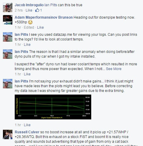

Now Adam is saying "There isn't anything in the tune that needs to be adjusted, the timing is good, the AFR is good, and the boost is solid." So the question is, is there anything you could do to the tune (e.g., higher boost) if you had a higher flowing downpipe/turbo-back on there (and maybe an intercooler) that you'd be reluctant to do with stock parts (or just an intercooler). If so, then an after-market downpipe/turbo-back may still be worthwhile. If not, it's harder to justify.
I mentioned it in another post, I put my Stage 1 tune which is more aggressive than any of Cobb's tunes with just the catback installed and stock everything else and the power increase was 1hp and gobs of torque. Here is the actual dynograph:
The reason for torque increase is because of a boost increase. That is going from ~20psi to ~22psi between 2500 and 3500rpm and they taper off the same at about 5,000rpms as the turbo is dying. This is why this car is hard to increase peak power as the turbo is dying before it even reaches the cross point of HP and TQ which is 5252rpms. The only way to increase peak power on the Fiesta is to increase the turbo's ability to create airflow longer than factory. If you don't increase airflow beyond 5,000's rpms your peak power is always going to be fairly similar. Adding a bunch of timing as the turbo dies isn't going to increase power either as the engine can only be so efficient and fuel can only combust at a certain rate. So the power increase we are having from the exhaust is from freeing up more flow, but not too much so there is still backpressure to assist in cylinder pressures during the overlapping scenario. This is another scenario where you have to find a happy medium with a small, high backpressure turbo.
