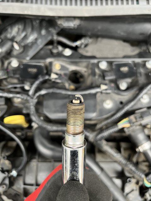

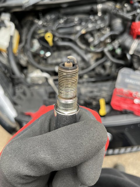

This has been a while now, but I pulled cylinders 1 & 4 spark plugs
