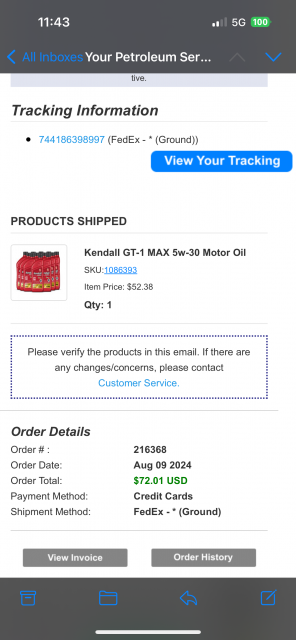

I ordered this yesterday with regular shipping and it just showed up about an hour ago. They don't mess around.
