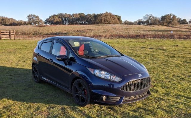

Thanks for reading! Here's a picture of my Fist :).
