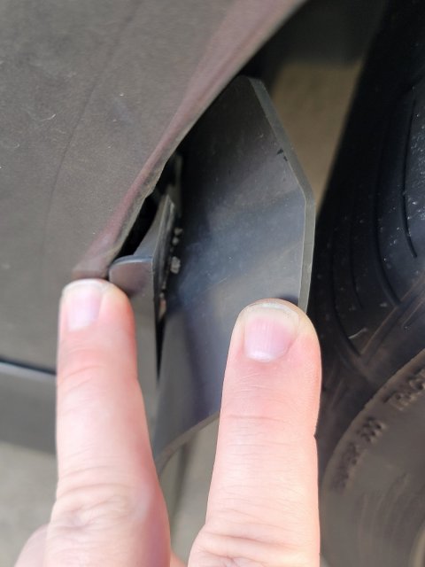

I agree with everything @M-Sport fan said. I got them because the rd I lived on was terrible and gravely and I could always hear the rocks hit the side of the car (cringed every time). They defiantly eliminated that. I will say that smaller gravel gets stuck up at the top of the flap. I have a "dentist type" pick tool that I use to get it out when I wash it. But yeah, for those folks that live up north it won't do much for the undercarriage. 20220905_161903_resized.jpg
