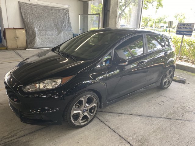

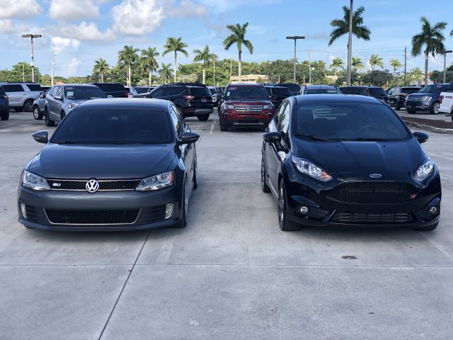

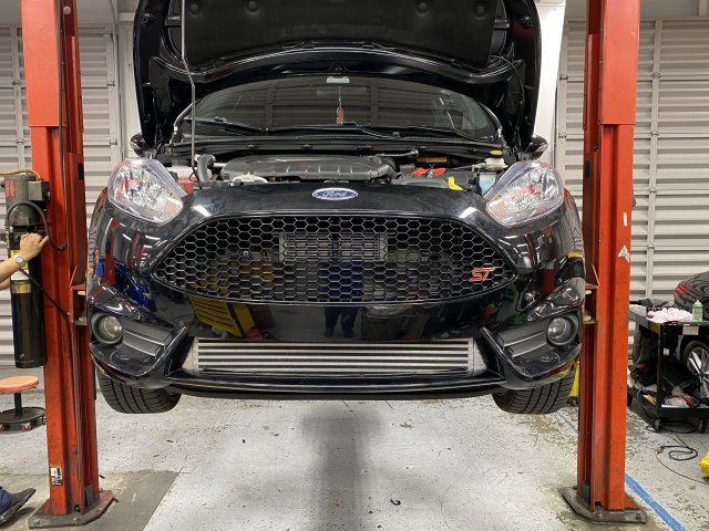

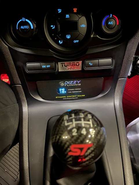

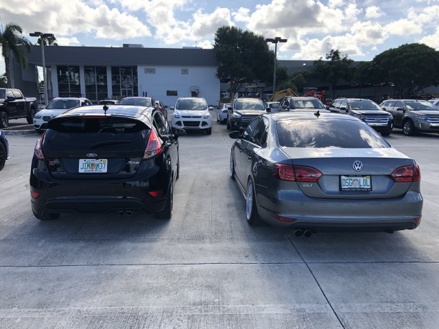

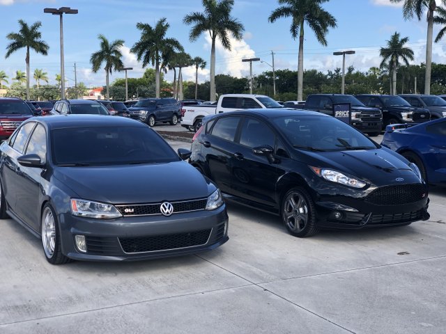

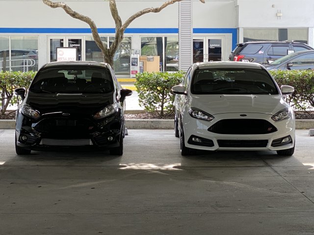

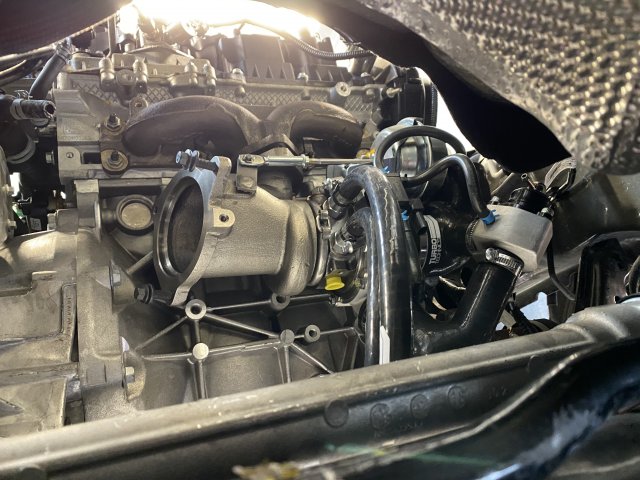

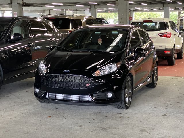

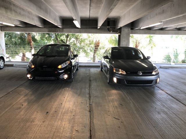

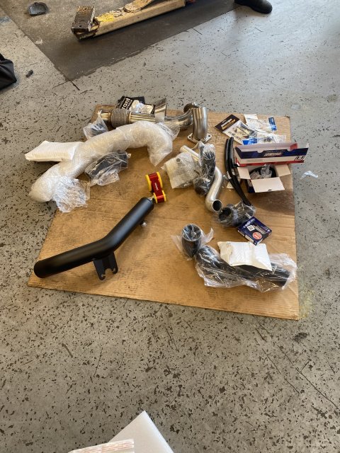

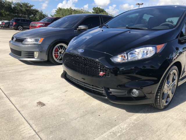

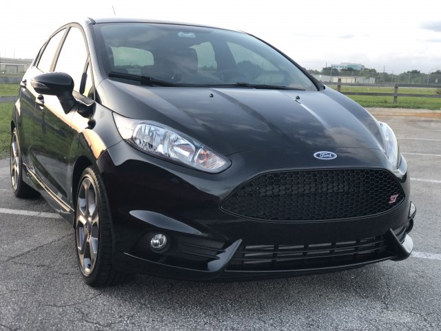

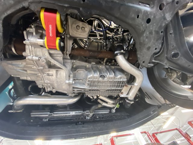

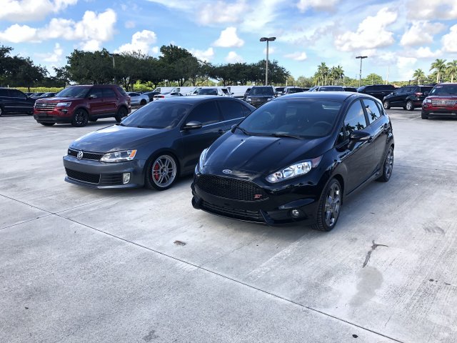

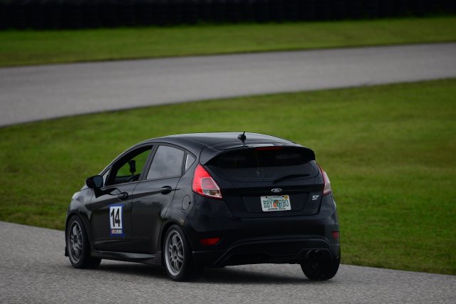

The Fiesta is a great car out of the factory, but when you throw money at it oh boy its becomes better! My 2019 Fiesta ST is Shadow Black with only Voice Activation Navigation as the only option. I bought the car July 15th of 2019 and I told myself I would try to keep it stock but that was the biggest lie I've ever told myself. The car before the Fiesta was a Jetta GLI that I built for the track and I wanted the Fiesta to see the track. I've seen so many reviews how the car is great out of the box but I wanted more. Currently I am running a Dizzy E40 Tune with the S280 Turbo and I want more!!
My Current Modifications are the car are:
Whoosh Ram Air Intake
Mountune Intake "S" Pipe
Whoosh Cross Over Pipe

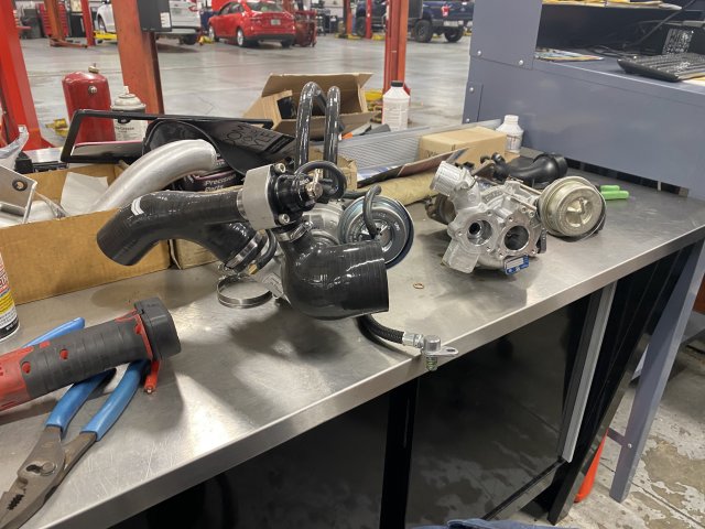

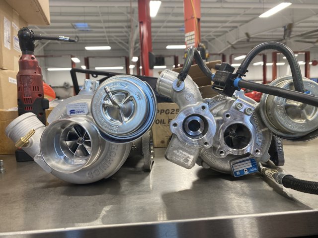

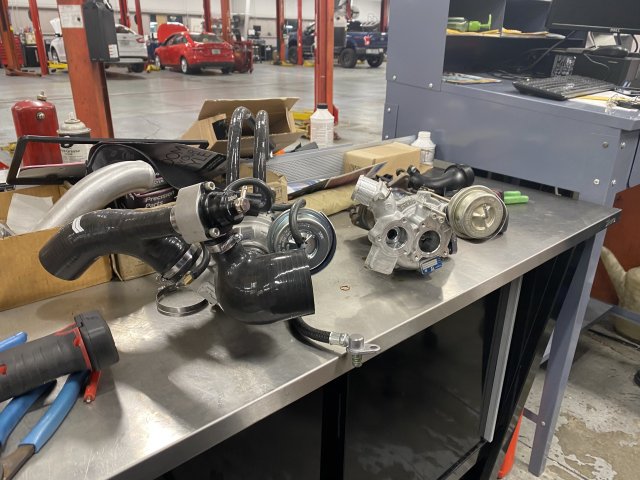

Turbo Technics S280 with Stock Wastegate (14psi Wastegate sitting in the garage waiting to be installed)
TurboSmart Kompact Shortie Plumb Back BOV

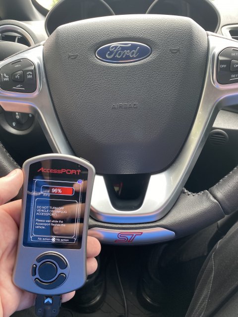

Cobb AccessPort

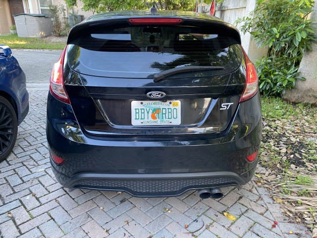

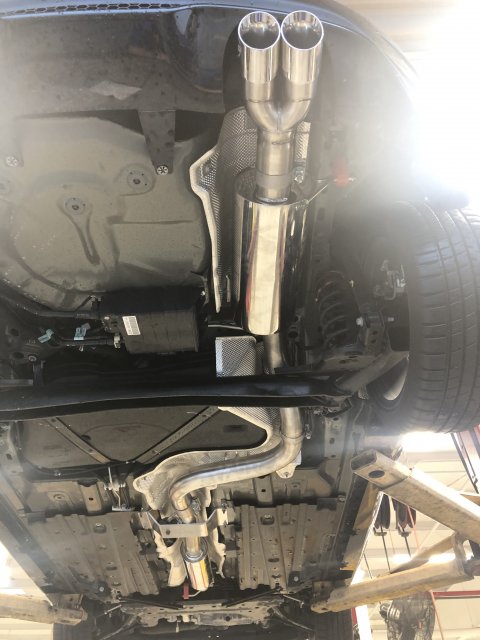

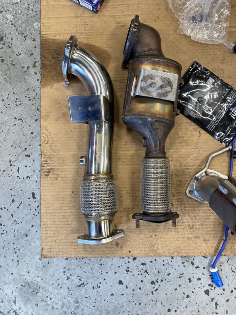

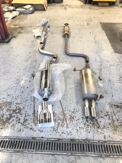

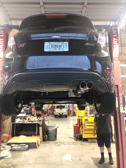

Whoosh Catless Downpipe V3

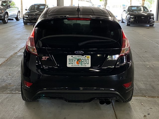

Thermal R&D Catback
Whoosh Exhaust Hangers

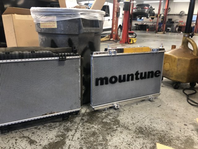

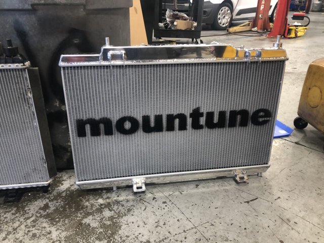

Mountune Radiator
MotorCraft 180 Degree Thermostat

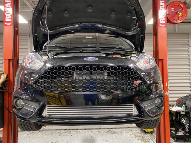

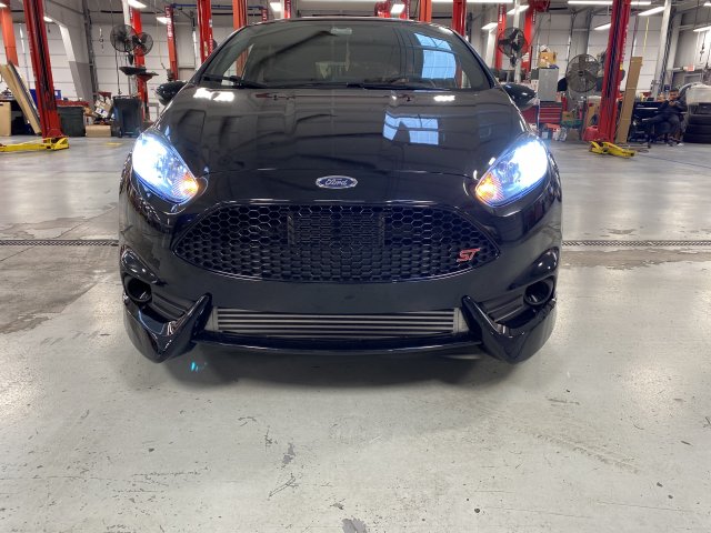

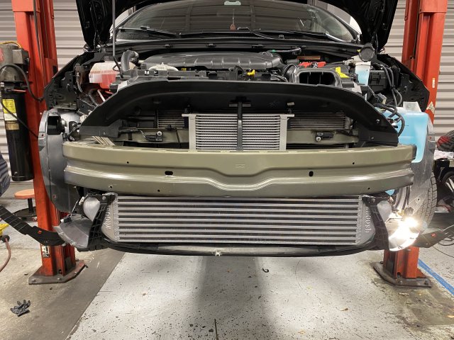

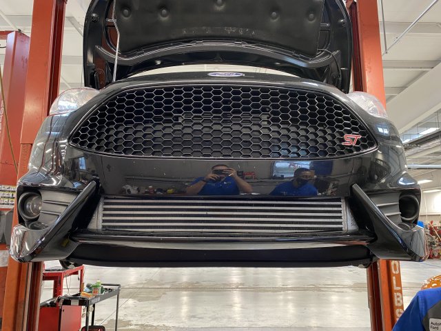

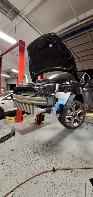

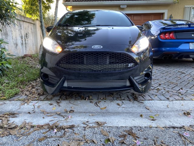

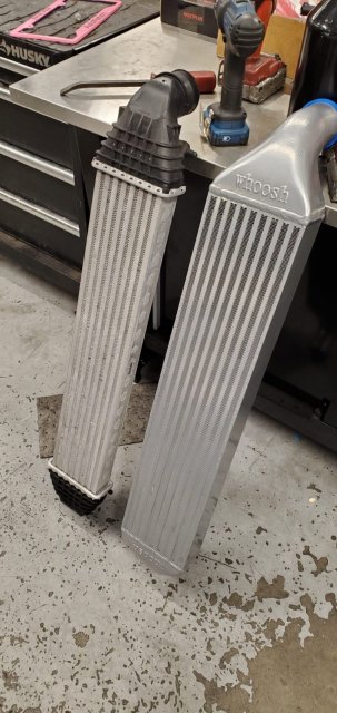

Whoosh V3 Intercooler
Whoosh Intercooler Pipes
Mishimoto Oil Cooler
CPE Rear Motor Mount
NGK Iridium IX Spark Plugs 6510

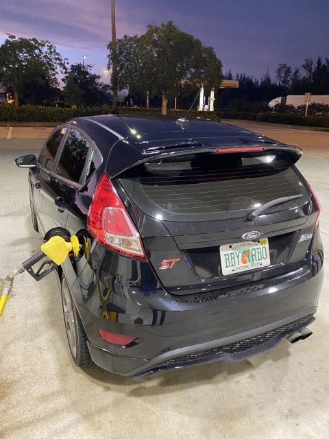

Dizzy Ethanol Content Gauge
1552 Cup Spoilers

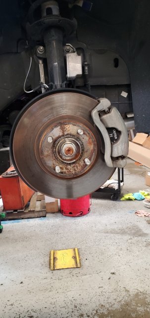

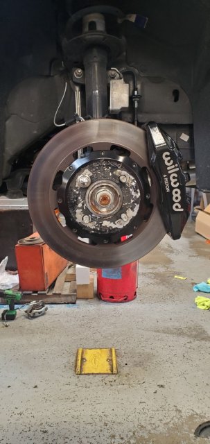

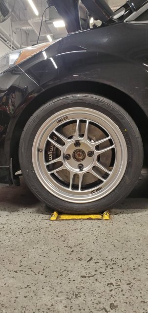

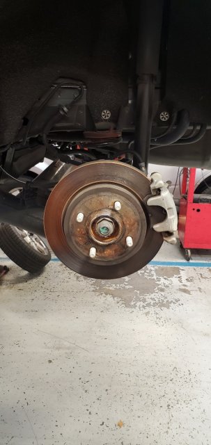

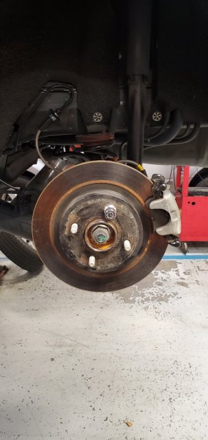

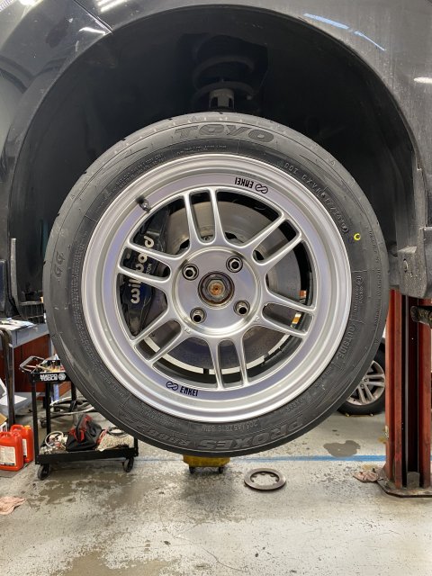

Wilwood 6 Piston Front Brakes
Focus SVT Rear Caliper Bracket and Rotor
Stainless Steel Brake Lines

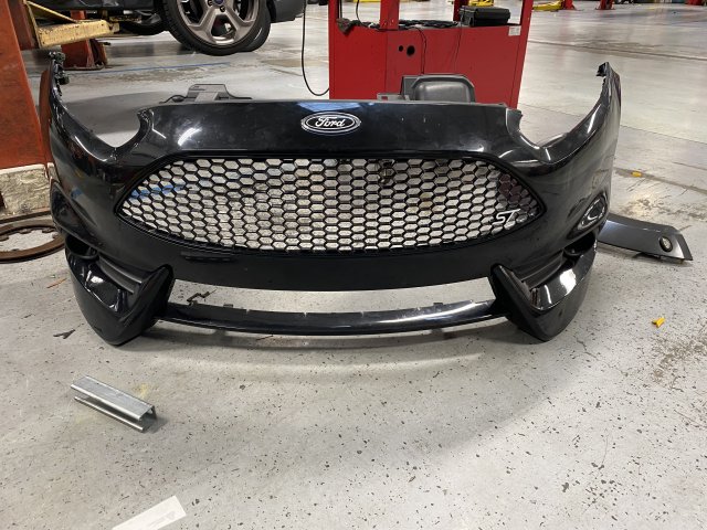

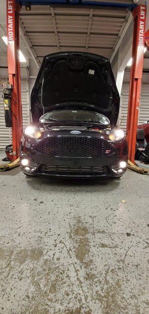

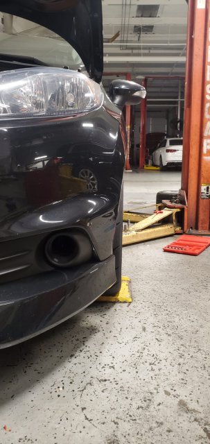

Whoosh Fog Light Delete Ducts
DNA Rear Sway Bar
DNA Rear Stiffening Bar

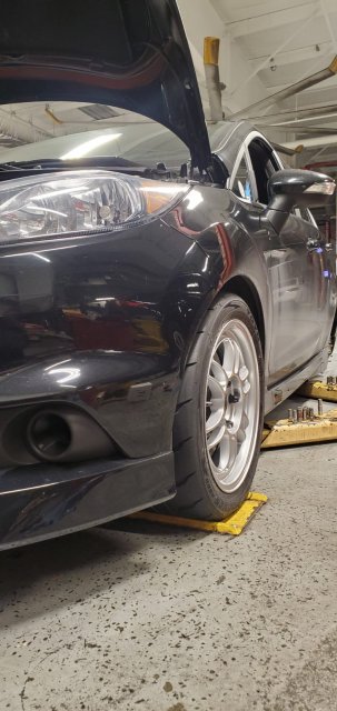

H&R 5mm Spacers (So the race wheels clear the calipers)
Fortune 500 Coilovers (Currently waiting for them to be installed)
DNA Racing Street Adjustable Sway Bar Endlinks (Currently waiting for them to be installed)
Mountune Short Shifter
RaceSeng Shift Knob
I haven't Dyno'd the car yet but I am planning on doing that soon.

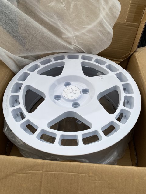

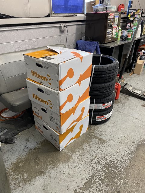

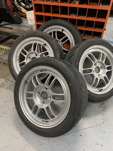

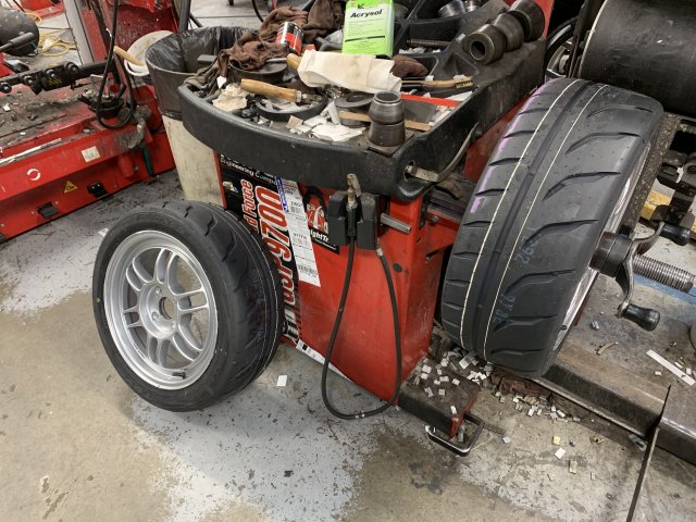

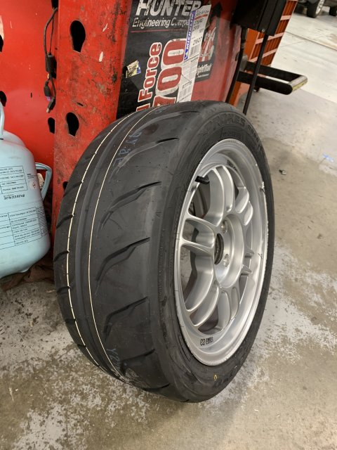

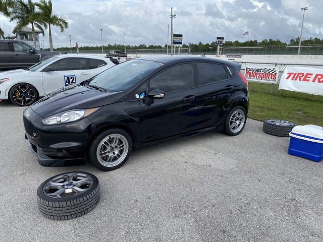

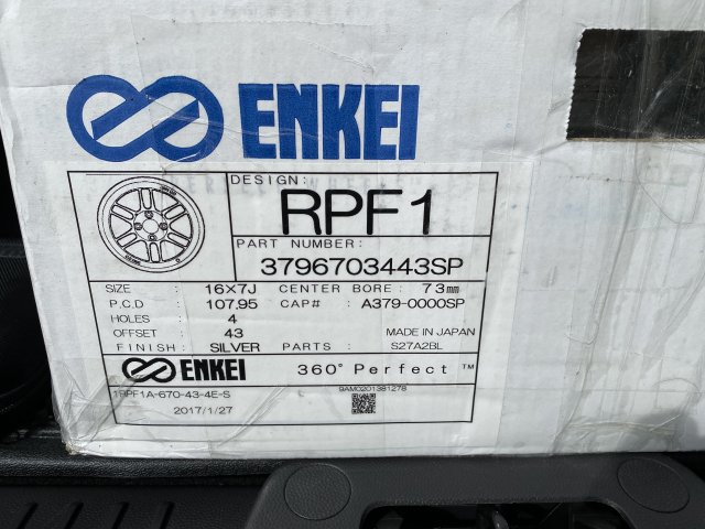

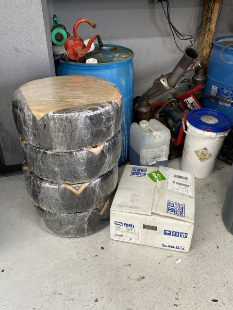

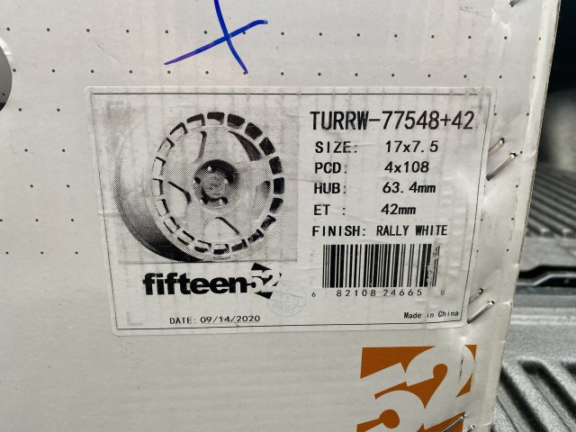

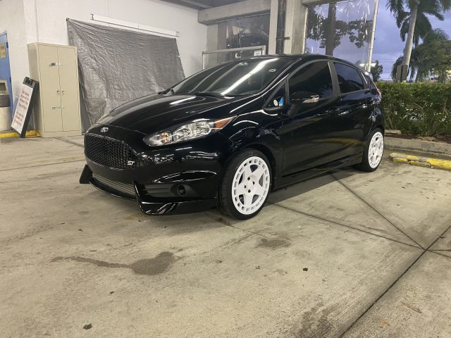

My Wheel Setups:

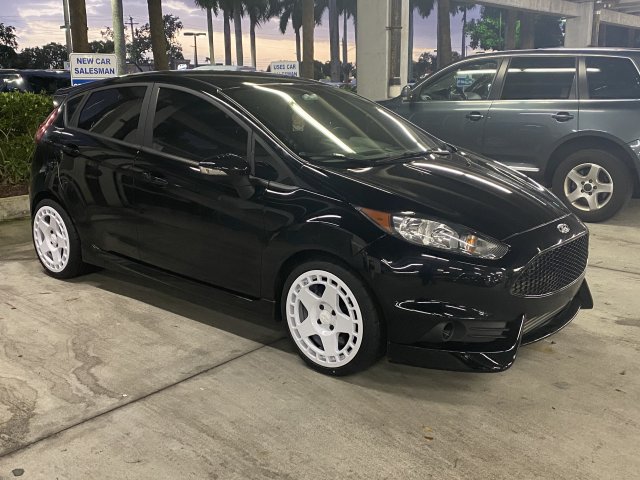

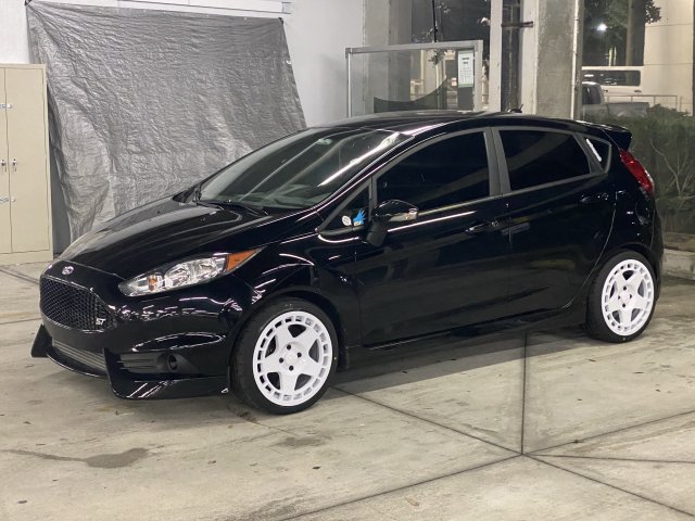

1552 TurboMacs 17x7.5 in Rally White Wrapped in a Firehawk Indy 500 205/40/17

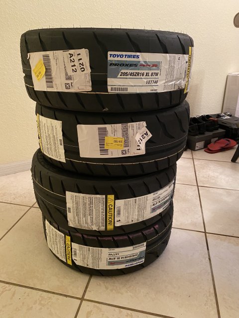

Enkei RPF1s 16x7 in Silver Wrapped in a Toyo Proxes R888R 205/45/16

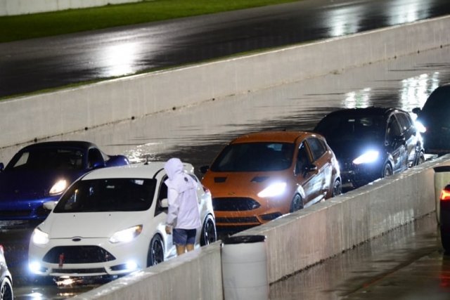

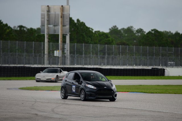

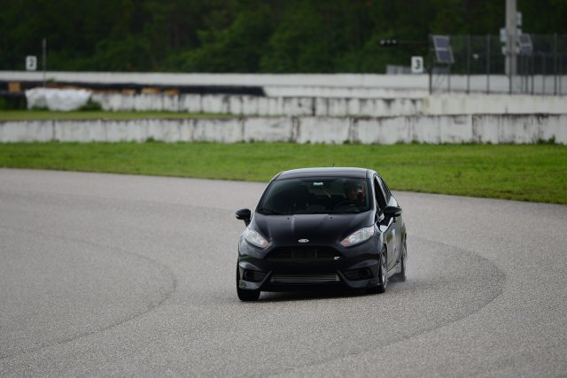

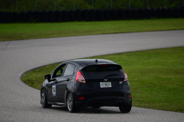

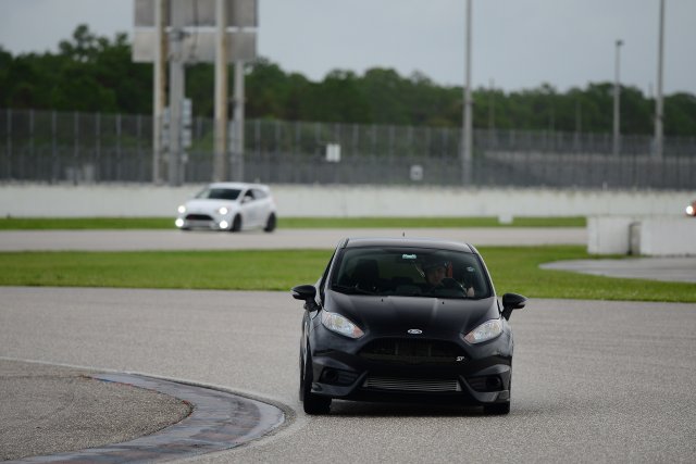

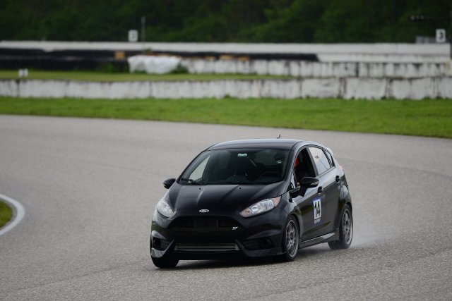

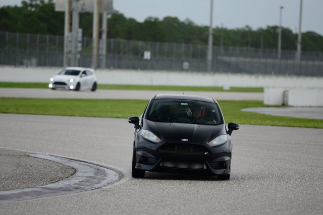

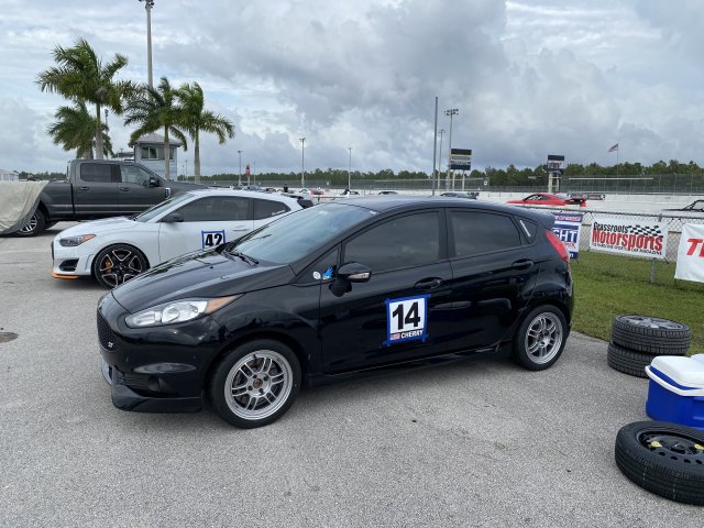

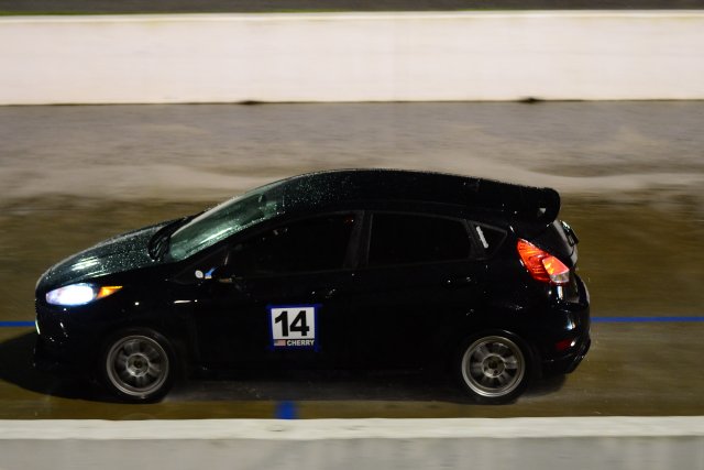

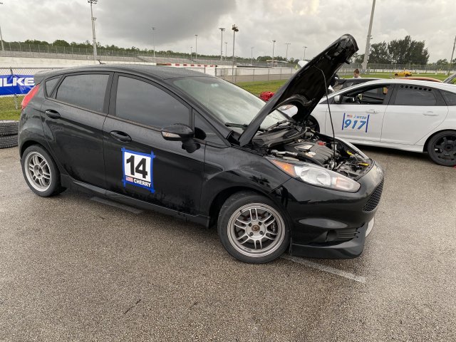

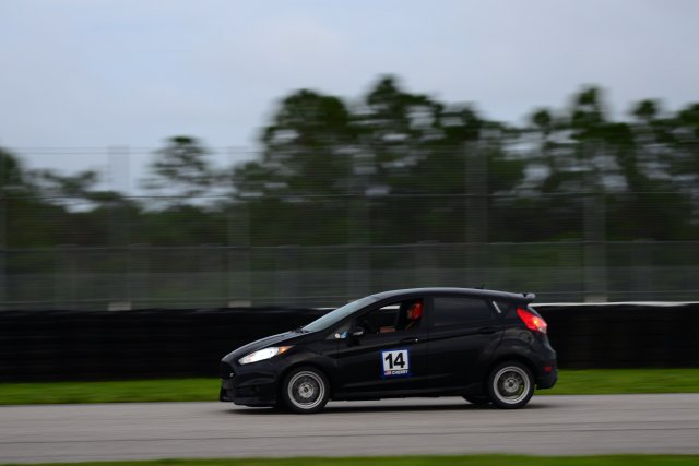

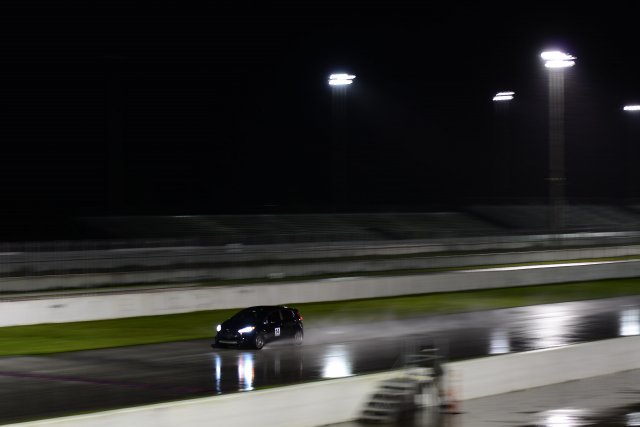

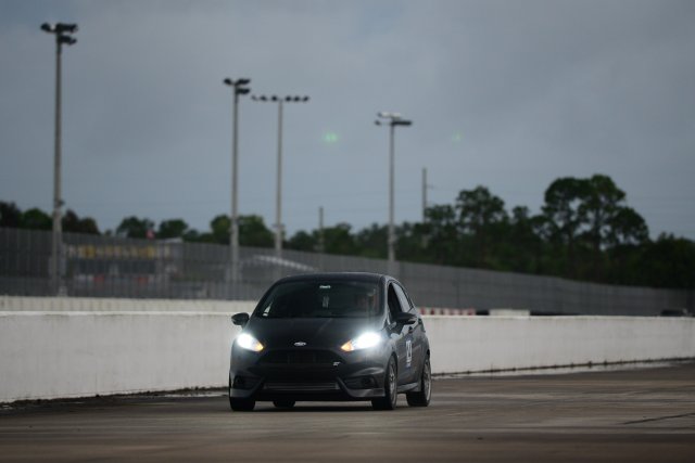

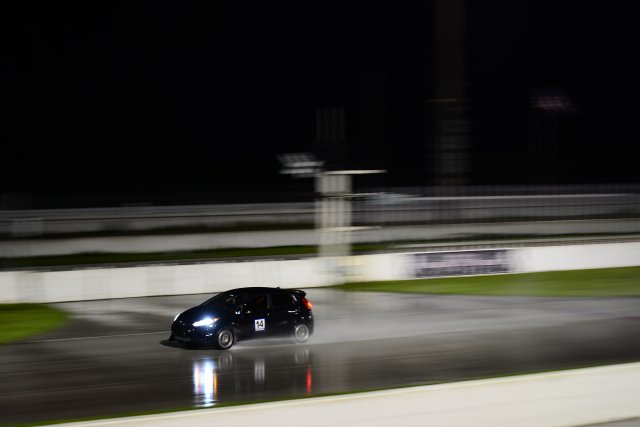

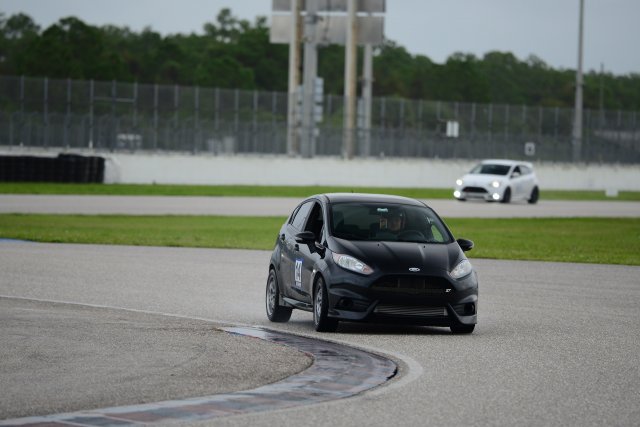

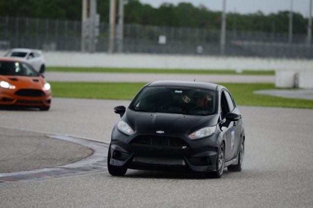

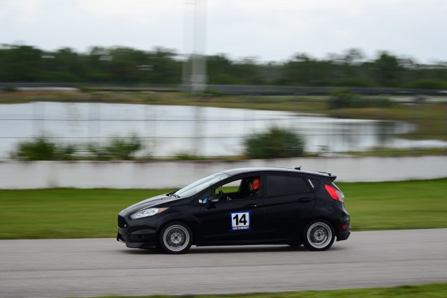

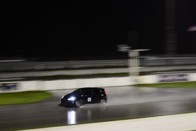

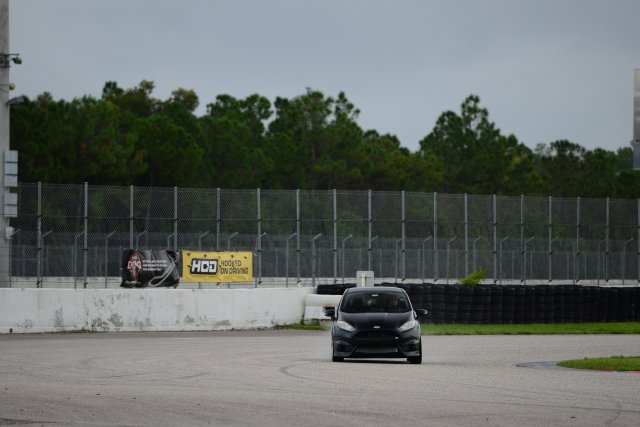

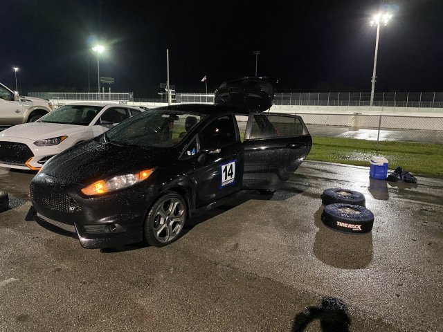

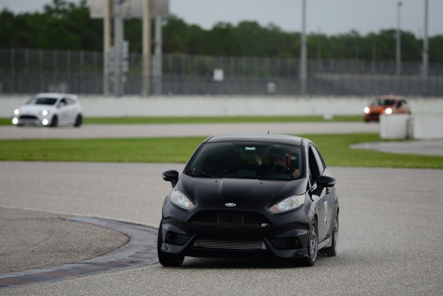

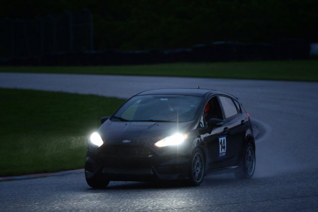

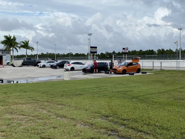

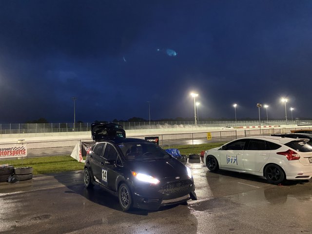

I have taken the car to Palm Beach International Raceway where it ripped!!! I can't wait to put the coilovers on and to get the car dialed in.
This car is awesome!! I love it more and more everyday. I will continue to post more pictures and progress of the car.

Welcome to a fellow S280 powered FiST.

The S280 is def the "it" turbo for the FiST right now✔️. I wimped out and went back to stock for other automotive platform pursuits, so I have to live vicariously with the FiST mods through the rest of you guys and gals✔😁

Dump the S280 and get your Big boy pants on for a Garrett GTX gen2 KIt or even Better the G-series Turbo kit both are BB also. Bigger intercooler like a BA would do you good also and keep Temps at bay. Maybe Aux 4 port or The HPFP is in order for your thirstiness in the quest for more power. Just remember the more power you want the Stock block can only go for so long also before it becomes lawn art..If I was you id be getting an LSD with a Aluminum flywheel and ST200 clutch kit and see if you like it even more. If not Step it up into the BT world of Garrett. Good luck!

I would suggest running the S280 and adding big injectors and a fuel pump and you will hit 400 whp if you want that much. You do not need to put a Garrett on. You just spent money on a S280 and he is advising you to dump a ton more cash into a Garrett setup.
Also that intercooler is fine for 400whp. You do not need to spend more on a intercooler.
Its pretty much the same size as a CPE . You do not need to go out and get a Bravo Alpha . Your build is not bad don’t let him fool you.
Its just Garrett Fanboi talk.
Stick with the fast spooling S280 you made the right choice.
He is just a Garrett Fanboi
There is a reason a lot of us are choosing the S280 over the Garrett. Its the modern smart choice.

I'll second the BA intercooler only because I had it and it was fantastic.
Coming from someone else with what I'd like to say is something called first hand experience * To OP id listen to those who have been there with certain mods aka intercooler and told they were inferior by a tuner as they turned the system into a giant Hair dryer and couldn't cool the system. Experience vs. Opinion here. I know what I would trust...Dont you?
#7958
6,363
5,994
#19
ah excuse me but you are exaggerating beyond all belief here. The Whoosh V3 is pretty much the same size as the CPE Delta Core which I have. They pretty much run a couple degrees over ambient according to data logs. That is not exactly a giant hair dryer lol and while the Bravo Alpha is good he is fine with what he has. Especially running the tune he is running. If he was going to go nuts for 400hp like some the crazed people like you then ya maybe the Bravo might be a good choice but at lower power and less boost it could be laggy in comparison due to size.
Oh and Magnetise was an admitted boost crazed HP nut pushing 34lbs.
