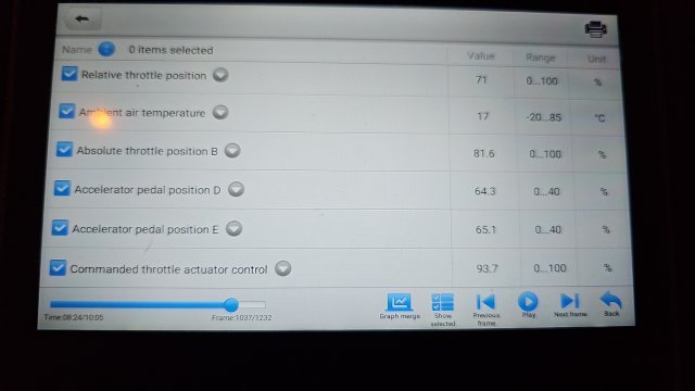

Hello guys! I'm a new owner and a car fanatic, im 22 years old and i got a problem since a bought the car, the problem happends when i floor it, its doesnt acelerate correctly, its like the power go down and it goes up again, its so weird to explain, so i bought a scanner and i saw that the only weird thing here was the pedal position and the throtlle body, do you know what is the problem or what can i do?

Was the Fiesta doing this before you bought it? Have you checked all the Boost hoses specifically the Hotside hose? These can come loose and make the vehicle like a turtle on acceleration.

Yes it was, i'll try checking those hoses and let you know
